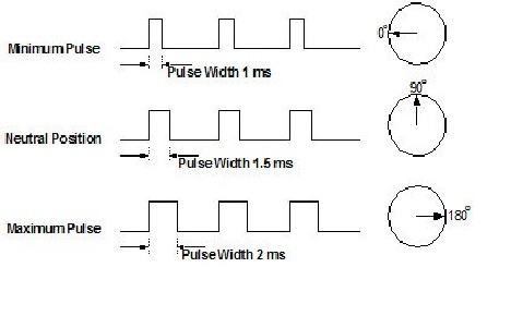

can anyone tell me what is the pulse width required for turnigy TG9e servo motor

    Default can anyone tell me what is the pulse width required for turnigy TG9e servo motor
    i have this servo motor but i do not know the exact pulse width which i must provide for proper working of this servo motor.
    i need it to move to particular angles based on my requirement.
    so can anyone help me
    All hobby servo's work roughly the same. The exact angle will differ slightly on each one. Above shows the basic signal vs degrees. Most servo's will accept a 50 hertz pulse (pulse every 20 ms) with duration of .9 ms to 2.1 ms, with a "neutral" at 1.5 ms.
