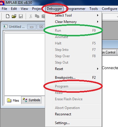

    I have check to make sure the Source-Level Debug is checked. How do you "program the device from the "Debugger" menu."
    Default Re: Can't Get PicKit3 to debug using MPLAB 8.63
    Have you tried to Debugger -> Program, and then Run?
    Thank you that worked. I never noticed the program command, I was busy hit run and looking at error messages. Thank you for your help.
