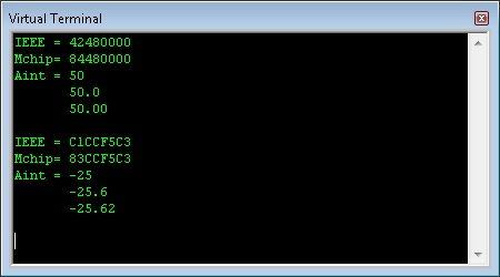

    I found some C code that helped with the transition. When I get everything running I'll post it. I was able to translate the 42480000 to 84480000 but I'm still getting nothing out of the ftoia call. The value of aint is the same before and after. I looked through the include files and the best I can tell is aint should be the variable being changed.
    aint = S_RateL 'copy over
    serout2 portc.6,newbaud,["hex value = ", hex8 aint]
    gosub ftoia
    serout2 portc.6,newbaud,["after conversion hex value = ", hex8 aint]
    C code ???? Yuck!
    And you're still missing Henrik's point. The Float goes in AARG (starting at AARGB2) not Aint which starts at AARGB3.

    Thanks to you both, that was the information I needed. I went through the readme file and the FP1832L.bas file again and I still don't see where it says AARG starts at AARGB2, but you obviously know what your talking about because I have been able to make progress on my project now. Thanks again.
