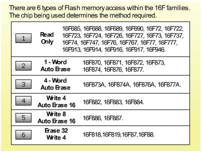

    Actually, there are 20 16F's that can write to their own flash memory.
    But there are 5 different methods, depending on the chip in use.
    > I can't believe that absolutely no one else has chimed in on this topic, though.
    After your first post, I started making a Flash movie, to show how to write to flash on a 16F88. And before I could even finish the first frame, this thread had already entered the "Confusion Zone", very similar to the "Twilight Zone".
    So I decided to expand it to include all the 16F's. Big mistake, takes too long. Should have stuck with the 16F88. Here's one of the frames which shows the different varieties. At that point the flash splits into 6 different explanations. 16F88 is #6.
    <img src="http://www.picbasic.co.uk/forum/attachment.php?attachmentid=2926" /><!-- Name:  FlashChips.JPG
Size:  34.7 KB -->
    It'll take too long to finish to be of help to you, and I don't think you are any closer to writing to flash on a 16F88, so I'll try to put it in Words.<hr>
    The only thing to really worry about, is that the Write to Flash only occurs when you write to the 4th word in the Block. Writing to the previous 3 words, only places the data in "Holding Registers".
