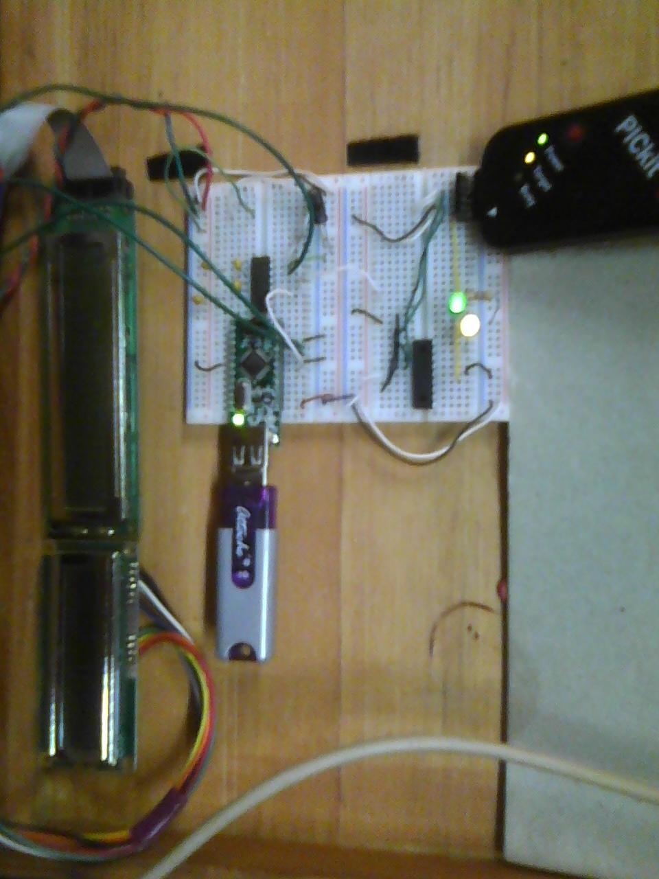

    can I use a breadboard for programming my micro's reliably or should I be using a ZIF adapter?
    All you need is a six pin header. No ZIF required.
    Here is a pic of a messy setup (a bad pic)
    <img src="http://www.picbasic.co.uk/forum/attachment.php?attachmentid=2979&stc=1&d=122612567 7 />
    Attachment 2979
    LOL, Hi Dave,
    Yea that's what I was Hopin' to avoid

    I have seen somewhere nice little flat ribbon cables attached to ZIF sockets and /or with nice little test probe ends.
    Now thats why i dont use bread board
    Ive gone for a slightly different approach, ive soldered wires onto the end of the tag strip supplied and put some small crips on which fit tag strips pritty well. Then i have a piece of veroboard with a ZIP in the middle and tag strips runnign down each side so i just move the wires to where i need them for each type of chip.
    Quote Originally Posted by chrisshortys View Post
    Actually, that is exactly what I started to do myself, Gotta order some 20 way sockets.
    I knew that picture would generate a comment or two I was checking out something for one of the posters here at the time. Shows how versatile the PICKIT2 is. ICSP is a piece of cake. And if you are doing a production run and want to use surface mounts all you need to add is some sort of header or connector to the PCB and away you go.
    However you use it, it can not be beat.

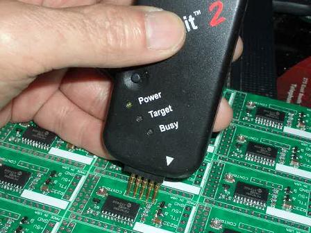

    For production, I use spring loaded pins on 1x5 pads on the PCB. Press the button (just below the thumb) and in just a few seconds, the device is programmed and verified.

    Quote Originally Posted by Joe S. View Post
    Where did you buy the connector ?
    Joe, I assume you are referring to the spring loaded pins. I got 10 of them for $6.97 about 2 years ago (I am still using the original 5) from here:
    http://search.digikey.com/scripts/Dk...name=ED8186-ND
