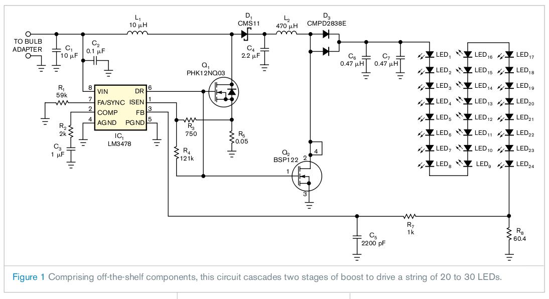

    He is talking about this

    Ahh, I see. I thought i clicked that link earlier but i must have only clicked the one in the text. That string of LEDs does look incredibly usefull! :P

    Maybe that's why they need the boost-drive...to overcome the reverse voltage...
    Heck, for all I know, those are actually LEZDs...Light Emitting Zener Diodes
    Attachment 2922
    Which has absolutely nothing to do with the topic nor with the article I cited.
    You're right. Sorry.
    On my screen, after opening the PDF, the LED booster came up first. I had to scroll UP to see the voltage monitor circuit.
