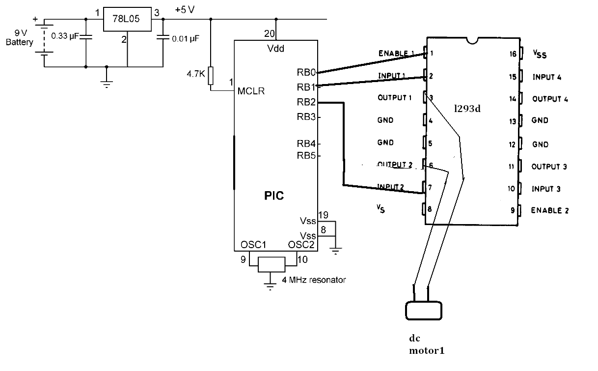

    How wrong I can be with that simple program?
    TRISB = 0 ' PORTB is output
    PORTB.0 = 1 'enable1 of L293d is always high so input 1 and input 2 are available
    start:
    PORTB.1 = 1 'input1 of l293d goes high, so output 1 goes high so turns left
    PORTB.2 = 0 'input2 of l293d goes low, so output 2 goes low so turns left
    pause 2000
    PORTB.1 = 0 'the opposite, turns right
    PORTB.2 = 1
    pause 3000
    PORTB.1 = 0 'stop the dc motors
    PORTB.2 = 0
    goto start 'loop

    And the schematic, the l293d is also connected right(ground,vs,vss) but not shown on this schematic

    more questions... your 9V battery. What kind is that? Is that the normal small flat one or something with some real juice in?
    How many mA does the motor take in start up current?
    Nothing wrong with PORTB, this is a different problem.. but please power the L293D separetly. Add config bits to make sure at least brown out off and watchdog off.
    /me

    See the schematic attachment about how I power the PIC. I will try those configurations bits! Thanks!

    Try to add caps (2* 0.1 uF) close to the power pins on the pic (one on each side).
    and was it a regular 9V battery or something more powerful?

    If that's a regular ol' 9v battery (little flat one like Jumper said), that isn't going to work well at all, at least not for very long.
    Dropping the operating frequency of the PIC might help.
    And of course, as Jumper said, put extra cap's everywhere.
    Your PIC16F877A is probably brown-out resetting every time you start moving a motor (or maybe one motor or both or whatever). The smaller PICs might be a bit less sensitive to power dropoffs, or maybe they're LF versions whereas the '877A isn't an LF version.
    Who knows...
    One thing I do know is that the schematic shown above could use a bit of redesign to make it more reliable.

    Help guys Iam starting loose hair for this project
    I think the problem must be the normal 9V battery, what I can use as alternative? Will be an alcaline 9V battery or something else be better choice. I notice also in LCD screen somehow the 2 power sources (9V battery and the 4x1.5V AA batteries are interfacing) maybe is the L293D drive chip to blame and try another one?
    I also replace resonator 4mhz with crystal 4mhz with 33pf capacitors so can be more accurate. I also defined osc 4 in program. I also use pbp247 compiler and mpasmwin520 assempler(this is from Compile and Program Options) and I use an usb programmer I bought on ebay with the following settings when I program the chip the watchdog is disabled (see the first attachment).
    I connected l293d chip successful with RC ports so to have only one chip, but my problem is that after some loops the circuit stop working!
    See the complete schematic in the second attachment. Please help me to do it more reliable!

    -Get rid of that 9v battery and make up another battery pack. Get a bunch of NiMH AA's and make another battery pack, anything but that stupid 9v battery.
    -Put decoupling cap's across Vdd and Vss on the PIC.
    -Turn off the brown out detect on the PIC in the config fuse options.
    -4Mhz osc - accuracy isn't going to help here. As long as it runs, it should be good.
    -USB programmer from eBay - spend the money and buy a PICKIT2. You'll be happier in the long run.
    -One power supply for the PIC, one power supply for the motors - good idea.... Separate grounds, not a good idea. Connect the grounds together.
    -Put low value inline resistors on the lines between the PIC and the L293D.

    Ok I changed the battery pack and already work well!
    For inline resistors 500 ohm will be ok?
    Jun 2006
    14
    Smile
    Ok guys it finally works! I replace 9V battery with 6xAA battery pack all circuit use that power source, I put 500 ohm inline resistors between PIC and L293D and a 0.1uF decoupling capacitor across Vdd and Vss.
    Thank you all for your great help!
