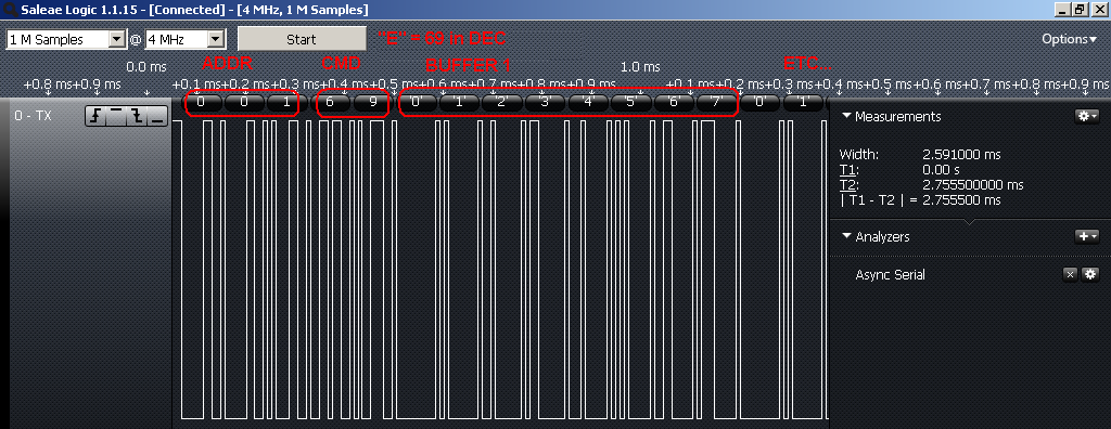

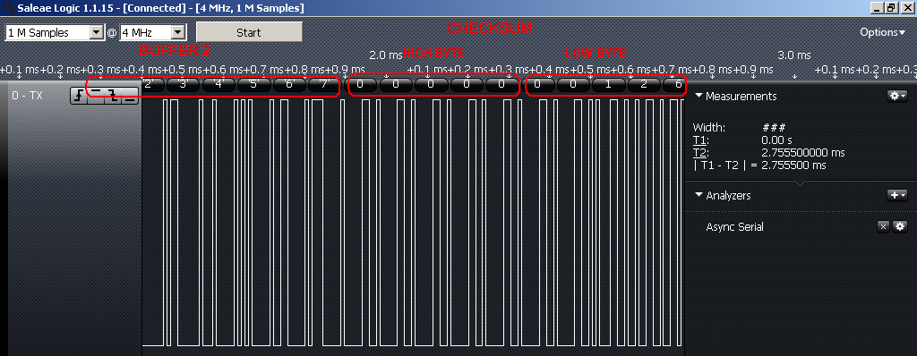

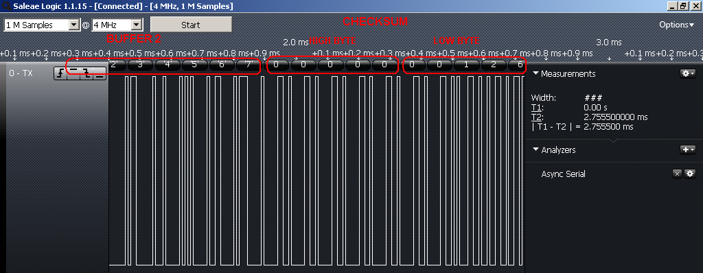

    This is what I do with DT_Interrupts on a serial stream of 115kBps on a PIC18F25k22 @44.2368MHz.
    "Buffer" is a circular buffer of 256 bytes. When BufferReady = 1, I use another pointer (ParsePtr) to parse the data.

    You can comment out the LCD stuff if you don't need it. I use a Saleae probe to see the data on the TX pin. The normal method is to connect to a PC using MAX232 chip (search forum for circuit).
    The interrupt is commented out because it is just a placeholder. It is not in working order, it's just there so I remember where I put stuff in my program. I adjust it to my needs when I need it. In this case, we don't need one in the Master.
    This shows how the data is sent across the TX line (display is too narrow on laptop).
    Name:  Saleae USART XMIT a.PNG
    Name:  Saleae USART XMIT b.PNG
