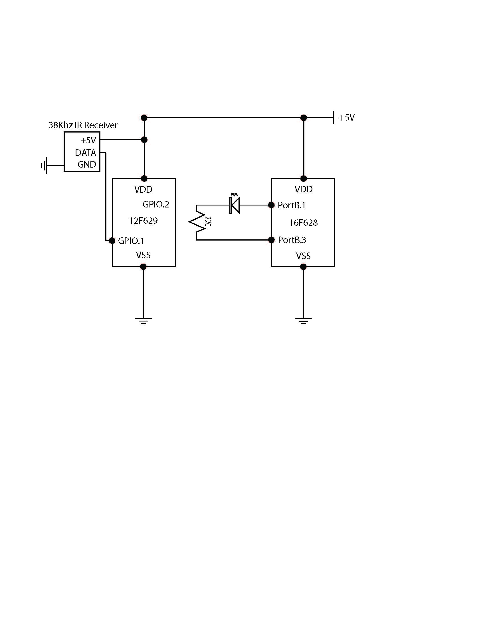

    I have been looking around at different posts and the internet and i can't find a solution, they all say what i am doing is correct but it does not work. I have attached a copy of the wiring for you guys to look at. The only other thing i can think of in the Baud Rate and the way its driven. Should N1200 work? or should i drive it TRUE?
    Thanks Again,
    Jeremy
