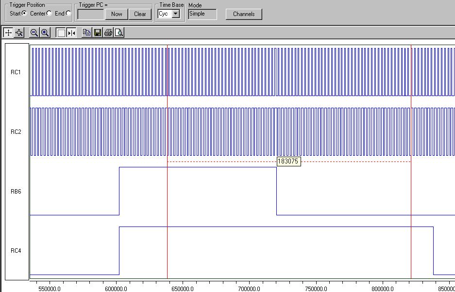

    Hello again.
    Still using PIC16F876A...
    This bit of code works quiet well: ie The PWM appears as expected on both channels.
    DEFINE OSC 20 ' use 20mhz xtal.
    DEFINE HPWM1_TMR 2 'Use timer 2 for both channels
    DEFINE HPWM2_TMR 2
    DEFINE CCP1_REG PORTC ' Hpwm 1 pin port
    DEFINE CCP1_BIT 2 ' Hpwm 1 pin bit
    DEFINE CCP2_REG PORTC ' Hpwm 2 pin port
    DEFINE CCP2_BIT 1 ' Hpwm 2 pin bit
    CVRCON = 0 ' DIS-ABLE REFERENCE MODULE
    CMCON = 7 ' Disable analog comparator
    ADCON1 = 7 ' Set Port to digital
    TRISA = 255 ' SET PORTA TO INPUTS
    TRISB = 0 ' SET PORTB TO OUTPUTS
    TRISC = 0 ' SET PORTC TO OUTPUTS
    MAIN:
    goto R_FWD ' Got here by doing the right thing.
    R_FWD:
    IF STEERY > (THROTL*2) THEN ' PREVENTS DECREASING PWM FROM GOING BELOW 0
    STEERY = (THROTL*2)
    HPWM 1, THROTL, 2000
    HPWM 2, THROTL-(STEERY/2), 2000
    PORTC.7 = 0 'LEFT_BACKWARD OFF
    PORTC.6 = 1 'LEFT_FORWARD ON
    PORTB.5 = 1 'RIGHT_FORWARD ON
    PORTB.4 = 0 'RIGHT_BACKWARD OFF
    PORTB.6 = PORTB.5 & PORTC.1 'RIGHT_PWM_FORWARD
    PORTB.7 = 0 'RIGHT_PWM_BACKWARD OFF
    PORTC.4 = PORTC.6 & PORTC.2 'LEFT_PWM_FORWARD
    PORTC.5 = 0 'LEFT_PWM_BACKWARD OFF
    However; when I run the simulator, I see the PWM on PORTC.1 and PORTC.2 as expected but the output on PORTC.4 and PORTB.6 is slower by an order of magnitude.
    Is this the simulator or some kind of aliasing, or is this as fast as the chip can run?
    I've changed the frequency from as low as it can go 1221 to as high as 5000 without much change in the simulated outputs. If I set it much faster than that then the PORTB.6 and PORTC.4 outputs stay on all the time. Again I repeat... the PWM outputs look like they should.
    I was hoping the simulator would let me avoid having to build a hardware prototype.
    Anyone have much experience with MPLAB SIM?
    As Bruce pointed out the correct syntax is "gosub R_FWD". This is correct in my code.
    But neither reply answers my actuall question. Also, as a fall back position I intend to hard wire the PWM outputs to PORTA.2 and PORTA.3 and use them instead of PORTC.1 and PORTC.2 in my equations. This is due to the fact I need the PWM on 4 pins. I have the PIC16F876A chips in house, so changing chips is NOT an option.
    The difficulty there is telling the simulator that there's a wire external to the chip! I tried generating the identical PWM signals on those pins but Arggggg... I give up lol. I even tried
    PORTA.2 = PORTC.2
    PORTA.3 = PORTC.1
    That doesn't work either. Seems like at 1221 HZ PWM the chip could "keep up" with a 20MHZ Xtal ?!?
    By the way, is there any plan to allow display of US or MS as opposed to only CYC in the Logic Analyser output? Converting CYC to real time is a pain!
    Cheers!
