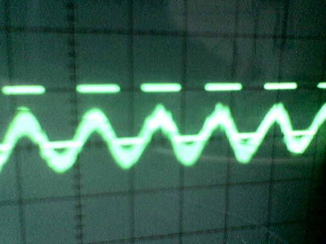

    My first impression GREAT!! but nono. Why? because The fecuency sampled is 420Hz, considering 0.000125 samples per second the period of the signal should be (1/420Hz)/0.000125uS = 19 samples aproximately. From what i am getting you can see that the period is around 15 samples, which means 533,3 Hz.
    So i Though maybe the comparator is not working correctly...but... Another modification to the handler to make porta.3 follow the comparator output showed this picture. Its a DTMF code not the 420Hz i used as sample.
    <img src="http://www.picbasic.co.uk/forum/attachment.php?attachmentid=2071&amp;stc=1&amp;d=1 191624484" width="160" height="98" />
    So the Comp is working fine, and the sampling is being done a the correct frequency.

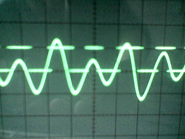

    Here i took the 420Hz Comparator Output.
    <img src="http://www.picbasic.co.uk/forum/attachment.php?attachmentid=2072&stc=1&d=119162493 3" width="160" height="98" />
    Could it be... this is my last one... that something is wrong with the Handler... maybe between Byte changes a bit is missing? Obviously i have no idea of what you did there, BY THE WAY you will laugh at my ASM code to check things at porta.3 it has to be awful !!. It works but is longer than the sampling part.
    Hope you can give me any ideas.
