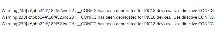

    Hi!
    I'm using MicroCodeStudio Plus and PICbasic Pro. When compiling i get this ERROR; See JPG attach.
    And here is the code....simple maths. (it is a part of another program)

    So than, after compiling, can I program the PIC even if I get this warning....Will this cause any problem. Should I ignore it?
    230 Collision in EEPROM @ Address
    An attempt was made to generate more that one value for the specified
    EEPROM location.
    Tanks again!
