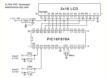

    Hello everybody, I have used pics before and I am still green, I managed to create inputs and outputs ok, used some time delays, but i now have a need to create a PIC managed voltage meter in the range of 0 to 2 volts., also must have four places. I have seen PIC controlled LCD and LED displays. Iam open on either. I do have the schematic for a PIC16F877A but no code! Can any body help with the code to get this project underway?
    Thanks in advance, I have tryed other forums with little to no responce, I am starting to believe that its not a easy task.

    I'm not sure if anyone could help without knowing details of your board. Maybe you'd like to consider posting the schematic of your board to get ideas flowing.

    Heres the schematic of a PIC 16F876A with a LCD display showing 2 lines, able to output 2 voltages as i need.
    This looks like what i need, i cant get any responce form the site that has posted this schematic!
    Its a pleasure to get a responce to the question, thanks again Jerson.

    The link you gave only allows ( with buying the '876 ) a 0 - 7v range ... by changing the input divider ratio.

    One thing you can do is to take away the resistor network on your analog inputs and just put a 1k in place of the 100k(for isolation and input protection). That resistor network is scaling a 0-70v input to a 0-5v in to the PIC.
    Then connect a 2 volt source to AN3 to serve as the high voltage ref. To do this you need to set register bits PCFG3-0 to '0001'. This changes the range of the ADC to 0-2V, instaed of 0-5v. You could use a simple resistor divider like 3k/2k or a precision voltage reference like a LMV431 or even a zener diode.
