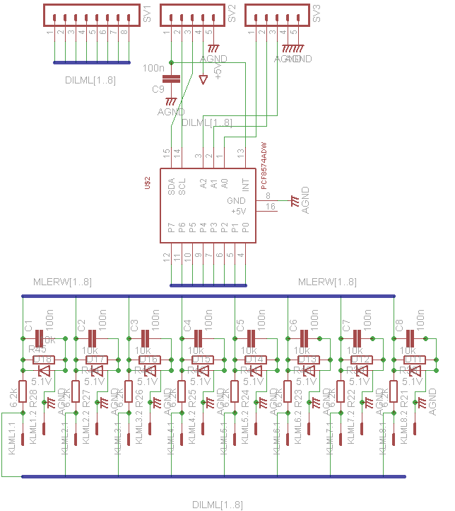

    I have Building a 24 Inputs Alarm Device,all is working fine,but :-) i have just a little Problem
    when I have a Voltage on one Pin between the HI and LO PDF Specification the INT is still remaining LOW and is blocking my complete INT.
    I use a 10K Resistor on the Interrupt Line,and a Voltage divider like on the Picture.
    Thank You for any Help
    Regards Pesti.

    I forgott to say that this Problem is happen just when the voltage is slow decreasing!
    I think that I should use a Schmidt Trigger between Input and pcf8574A.
    Regards Pesti

    Or use a high value pullup resistor...unless it's that slow voltage drop that you're looking for.
    Hi Skimask,
    No I'm not looking for Slow Voltage drop,I need a Secure Alarm Device,this was just a coincidence that I found this Error.
    I can use the Device in two Mode :
    Mode1 = On/Off to Ground
    Mode2 = Voltage On/Off Between 5-15 Volt
    The Problem is that when the Input Pin Voltage is going Slow from High to ~ < 1.9 Volts then the INT switch to Low and is remaining Low.
    Regards Pesti
