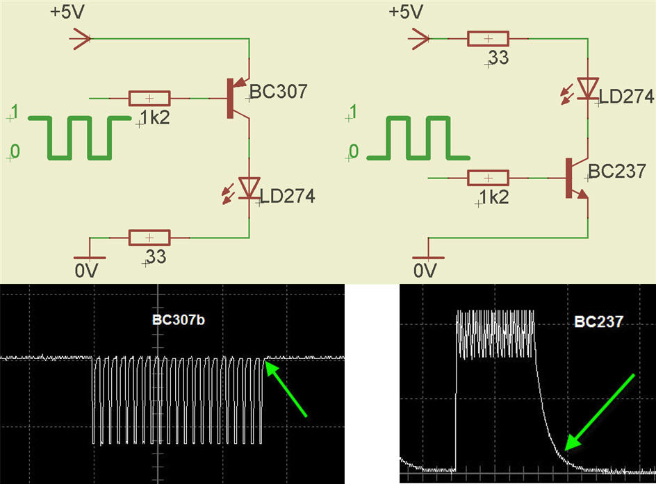

    I'm driving a transitor with a PIC; it is meant to control an IR led for a remote with a 38kHz carrier freq.
    Depending on what PNP or NPN transistor I use, the final signal edge is smoothed (green arrow).
    Clearly, the signal is much better with a PNP transistor (BC307b graph).
    Since both transistor suppose to be "complementary" and have identical specs, I don't understand why the edge (BC237 graph) is smoothed that way while using a BC237 NPN transistor.
    Any clue? Is this due to the IR-Led's capacity?

    Never heard of transistor parasitic capacities ??? ...
    Search Keyword is " Totem pole " ...
    Also, try to use a // capacitor ( 1nF) on your 1K2 res ... or a BAT85 ( Schottky ) diode ... in the right way to "pull off" electrons from the trans. base !!!
    You might see a litte enhancement.

    I don't think the Voltage waveform at the collector matters, since the LED operates from Current.
    According to the datasheet, the LED has 25pf capacitance. So when you turn off the transistor, that voltage can only dissipate thru the relatively small leakage currents.
    To allow the LED to discharge faster ... Placing a resistor across the LED would probably improve your waveforms, but it won't change the function and will only consume more current.
    A better indication of the Drive Current would be to measure the voltage across the 33 ohm resistor. Which should be very "square".

    The second example show that OR your base resistor is a bit too low OR the source can't give enough current to your transistor base OR you o'scope can't draw the wave properly.
    448
    Perhaps a resistor between the base and the emitter (around 2.2K) might help the transistor snap faster.

    Let's be honest ... and use the tools for what they are intended to do ...
    I couldn't try Alain's suggestions up to now; don't have any Schottky diodes neither 1nF capacitors... will be bought and tested by tomorrow evening.
    Amateur ...
    My initial question was more about to understand the difference between both transistors since nothing else changes in the circuit.
    This is exactly the same feature : junction capacities to discharge ... a strong cut off is obtained by polarizing the base to - 2 to 3 volts ...
