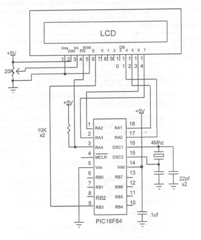

    Hi guys,
    Ok, I am at my wits end. I've come back to Pic and Picbasic pro from AVR so I can rapidly develop some basic circuits I need for the homestead. I spent two days working on two simple (well should be) circuits and cannot seem to get anything working except PWM on 16F628.
    I wanted to make a turns counter using a hall effect and LCD connected to a 16F628. I have an old LCD backpack but it just sends garbage to the lcd as if the controller on it has been zapped by static or something.
    So I fired up one of the many new LCD's I have and using LCDOUT I still cannot get anything working. I set up the 16F628 and made sure three or four of them were working on the test board and all were fine and could output PWM on CCP1 etc, but no LCD even after hours of checking and rechecking connections and filtering power etc. It's got to be coding issues. Don't laugh too hard, I have not written in basic in years now
    Here is the circuit I am using and code:
    @ DEVICE PIC16F628, INTRC_OSC_NOCLKOUT, WDT_ON, MCLR_OFF,BOD_ON, LVP_OFF, CPD_OFF, PROTECT_OFF
    TRISA = %00011111
    TRISB = %00001000
    CMCON = 7 ' PortA = digital I/O
    begin:
    LCDOUT $FE,1,"Testing...."
    LCDOUT $FE,1
    goto begin

    Blocks on the LCD, yes/no?
    Contrast dialed both one way (to Vdd) and back (to Vss), any changes in the screen?
    Put a 'heartbeat' LED on the board, make sure the thing is actually running...
    I may not be looking at it correctly and I think LCDOUT over rides it???
    The TRISA posted has your LCD pins set for input?

    I see no LCD defines in your code... please put them in.
    They are in the PICBASIC manual and tons of examples on this forum. Set them up for the way you've got your LCD wired.

    Yes, contrast works on three different (brand new) LCD's. All LCD defines are now at default which is:
    PORTA.0 =Data bit 4
    PORTA.1=Data bit 5
    PORTA.2=Data bit 6
    PORTA.3=Data bit 7
    PORTA.4=R/S
    PORTB.3=Enable
    R/W is grounded
    I Disabled MCLR to eliminate the need for pull-up and hassle. I also tried TRISA=%00000000 and TRISB=%00000000. I will post anything you need. Pictures, or anything else. I can even switch to a breadboard and eliminate possibility of circuit board issues (proto board) although I have spent literally 20 hours soldering and de-soldering an looking at every little solder joint, then using PWM and other commands to make sure the chips are good and working properly.
    Thanks for your help on this. Very, very much appreciated...

    This should be what I have setup at the moment:
    (CODE)
    DEFINE LCD_DREG PORTA
    define LCD_DBIT 4
    DEFINE LCD_RSREG PORTA
    DEFINE LCD_RSBIT 4
    DEFINE LCD_EREG PORTB
    DEFINE LCD_EBIT 3
    DEFINE LCD_BITS 4
    DEFINE LCD_LINES 1
    DEFINE LCD_COMMANDUS 2000
    DEFINE LCD_DATAUS 50
    (/CODE)

    try using with the configuration bits as watchdog timer off and brown out detect off, power up timer on and oscillator as XT

    I'm still pretty newbie to this stuff, but I had 2 issues that drove me nuts for a while that you never kbnow, could be one of your problems. One was that, for some reason, no matter how many times I read the PBP manual for the LCDOUT command, my mind never saw the "Flags = 0" part. Some one here pointed that out to me and that fixed one issue. The other issue was that I was getting garbage displayed sometimes and I could not display a number ending in "0" or "P". It turns out that the voltage rating fro the LCD was a minimum of 4.7 V and with the resistor I was using, it was about 4.62 or so. I changed that resistor to get the voltage up in range and that solve my bizarre problems.

    Thanks guys. It's working now. Looks like the fuse settings as Abidr mentioned was one problem and the flags=0 like G-hoot mentioned was another. Thanks for all your help!
