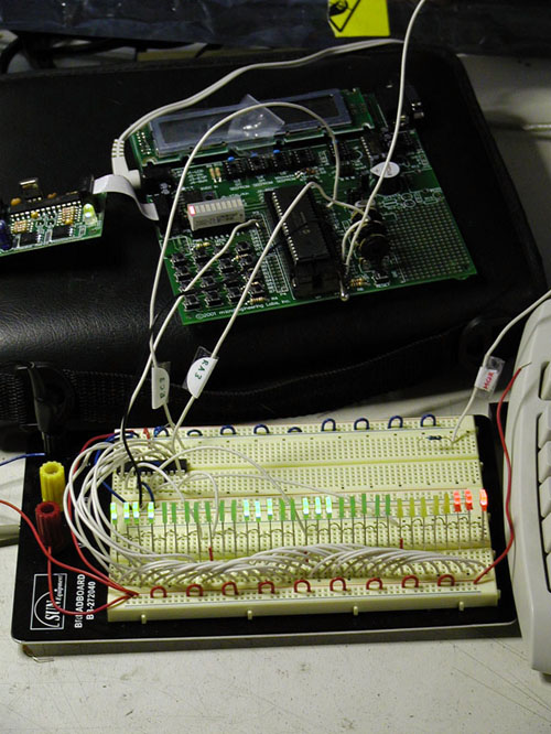

Hello Everyone! I'm progressing with my Tach project. I finally have all the parts
I need at least
Things had been progressing until I ran into this bug...
The Circuit:
I'm using a 16F877 and a Max7219. I have each individual segment attached
to the anode of a discreet LED. The cathodes are all connected common to DIGO
of the Max7219. I have 8 LED's total connected (using the DP's output too).
The Code:
I've taken code written for the Basic Stamp 2 and modified it to work with my
PicBasic Pro / hardware setup. The final version will have 32 LED controlled
by Max7219 & 16F877. Code is listed below.
The Problem:
The code will count binary up to 14. When it reaches 15 (f) or 00001111 it
completely halts and all the LED's turn off. I thought it was pulling too
much current so I ran the shiftout function with %1111111111111111/16 which
turned on all the LED successfully so I'm guessing this is not an issue of
drawing too much current.
Request:
Anyone have PicBasic Pro Code that supports the Max7219 driving LED's and
not Digits? Ideally with the 16f877 and the microcontroller. If not, I can
remap the I/O pins.
I've explored modifying the scan limit, decode mode, intensity, shutdown
mode etc. still no favorable results.
Thank you for your time,
Netjammer-
