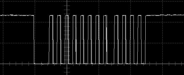

    This is an example of a 13-bit IR pattern I measure on a TSOP4838 receiver module.
    <img src="http://www.picbasic.co.uk/forum/attachment.php?attachmentid=2701&stc=1&d=121464754 0">
    At the start, my prog captures the incoming pattern sent continiously until it determines the starting-bit (first one after the pause between two patterns) and the number of bits (Bit-Count) in the pattern.

    According to your previous message, I might raise the timings accuracy with RCTIME instead of using PULSIN. Unfortunately, I can't get it to work using RCTIME.
    What am I doing wrong, please?

    I saw the leading PULSIN command in your previous post and tried this already. The result is the same as without PUSLIN but bits are shifted (not important at that time since the bits are sorted lateron).
    But why should the preference go for a PULSIN command first?
    I notice while using RCTIME, the measurements give slightly lower results (i.e. PULSIN = 355, RCTIME = 349) which looks good.
    Any idea why I get a result of 0 or 1 at bit 8 (sometimes bit 7)?
    NB: thank you for noticing the variable mix - I corrected already.
    Roger

    ... just to be sure to catch the first pulse ... RCTime is somewhat "out of normal use" for the leading pulse ... result is not guaranteed !!!
    your scoping looks strange ... just at bit 8 !!! ... try to raise the TSOP decoupling caps value and to place a ~ 50 - 100 pF as load to the TSOP output - that could catch possible ns glitches ...
    Also take care to have neat 0-5 v levels : the pic Thresold is @ ~1.5 v for TTL inputs ... and Schmitt trigger needs "good" levels ...

    I can't see any change with the decoupling cap and the power is ok. I'll go for some other values and check again.
    PBP manual: PULSIN normally waits a maximum of 65535 counts before it determines there is no pulse.
    It looks to be the same for RCTIME... but as you say, RCTIME has not the same behaviour as PULSIN.
    I think, depending on the IR remote type and protocol, I miss the first bit of the pattern.
