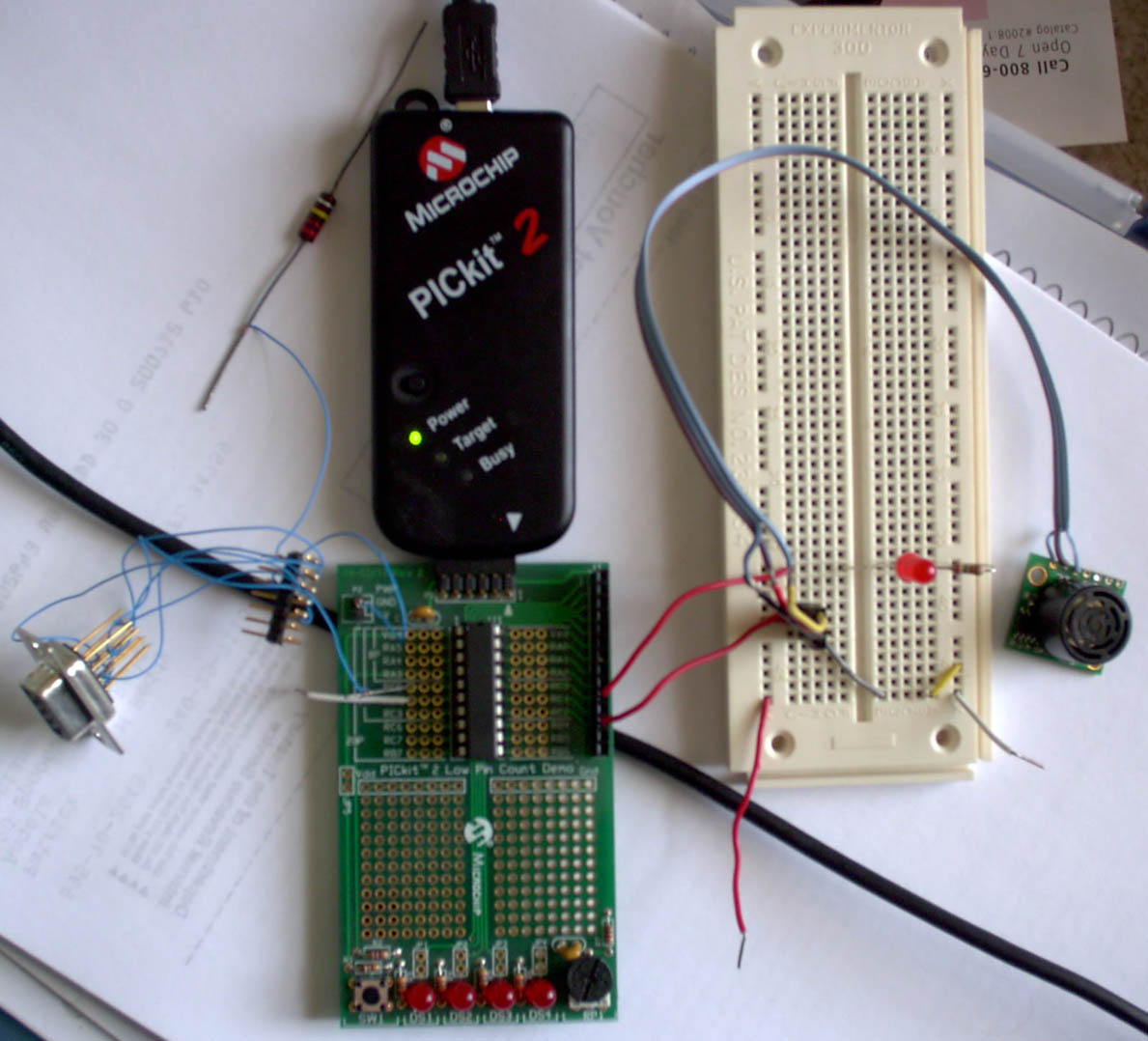

    My circuit is a bit ugly at the moment, just something thrown together for testing purposes. I'm using the PICKit2 proto board with the sensor plugged into the headers via a breadboard and the serial connection to the PC wire-wrapped on the proto board. I'm attaching a photo of the setup. It output to Hyperterminal with the same breadboard connections.

    Well, finally I've got this thing working. I got suspicious of Microchip's prototype board and just breadboarded the whole thing, and it worked perfectly.
    I think I will go with an external ceramic oscillator for the final circuit, for the sake of reliability. If I hook up a 20mhz oscillator, all I need to do is set @ device EXTRC_OSC_NOCLKOUT, define OSC 20, and get rid of the OSCCON completely, right?
