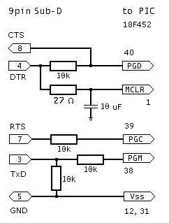

    Gentlemen, please find attached the schematics for a LVP "cable" (?) for 18F452 PIC.
    I did "melt" mr's Lothar (1) design with mr's Jose Pino (2) design, and yes, it works.
    (1) = http://home.vrweb.de/~lotharstolz/st...vpc/index.html
    (2) = http://www.josepino.com/pic_projects...programmer.jpc
    As software, I use MPLAB v8 to produce .hex files, and then ICprog to move it to PIC.
    If there is any question I can answer, you are welcome.
