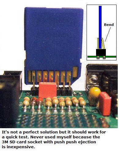

    Found this about an hour ago. Tried it... Works like a champ. Take an old 'female' floppy drive connector, plug an SD card into it. Pins line up almost perfectly.
    And who doesn't have a few floppy drive cables laying around....
    Could it be any simpler than this?
    http://uanr.com/sdfloppy/

    Hey mister_e, do you have any sample routines to share that make use of SD cards?
    It would open up new worlds to be able to move from I2C EEPROMS to 1Gb SD cards!

    Also possible:
    Best regards,
    Luciano

    True, I'm kind addicted to MikroE solution for development thingy...
    ~18USD everything you need
    http://www.mikroe.com/en/tools/mmc/

    Use the email link to contact the author of this page:
    http://www.turtlesarehere.com/html/data_logger.html
    and he will share his AVR routines which can be easily ported to Microchip assembler.
    I didn't really require BASIC code. Assembler source is actually quite abundant.
    The routines I have access the SD card as a mass RAM with no FAT system,
    which is the same way we use I2C EEPROMS.
    Art.

    Is something similar already available somewhere?
    An SD card socket has a switch to detect if the SD card is inserted.
    This switch is useless to detect if the user removes the SD card
    from the socket while data is written to it. With the solution
    below, it is possible close the file as soon as the user opens the door.
    (The file can be closed before the card is removed from the socket).
    I am searching something like that:
    Best regards,
    Luciano

    Even better! Nice find...
    Quote Originally Posted by Luciano View Post
    Best regards,
    Luciano
    Kind of SD card reader Bay or sort of... well, never saw one myself yet
