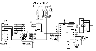

    I'm woking on project for "sms remote control" so I can remotely control devices via sms of mobile, I have the nokia 6210 model which support AT commands for simplicity, first I connect the mobile with PC and using Hyperterminal to send AT commands but nothing work so I search until i found the DLR3 circuit so I build it and try again and AT commands working well without any problems , second I need to use PIC16f877A instead of PC so I connect PIC17f877A to (fbus TX and fubs RX ) fo mobile through 1Kohm resistor and send AT command from PIC and working fine , but main problem is I can't recieve anything from mobile but PC recieve , so I don't know where is the problem is't hardware of software

    I don't know anything about that, but is this possible that the Fbus signal is 3vpp? If so you must have a level converter between your PIC and your Telephone, unless you may have weird results.
    Still possible in think to supply the PIC @ 3V. Look the datasheet if it works @3v and 20MHz...
    EDIT:maybe Fbus is open collector type too?
    http://www.panuworld.net/nuukiaworld...les/basics.htm
    I try using a converter like that max232 and ds275 but the same problem I can transimit but i can't recieve , I will try to use 3V power if its will working or not ?
    try a simple pull up on your PORTC.5 pin.
    If you use a MAX or else inverter, you may need to change your baudrate settings to INVERTED mode (16468).
    Did you tried with a PC and a MAX232?
    http://www.panuworld.net/nuukiaworld...ables/fbus.htm

    How can i connect pic with nokia? must I use max232 or Fbus cable?
    May 2007
    Republic Serbia
    105
    You cant use max232 on nokia 6210 or same type of nokia!
    Level is 2.7V and you must make special cable named DLR3V.
    I was make that and it work 100% good.
    By the way u must work with nokia6210 on 115kbps not 9600!
