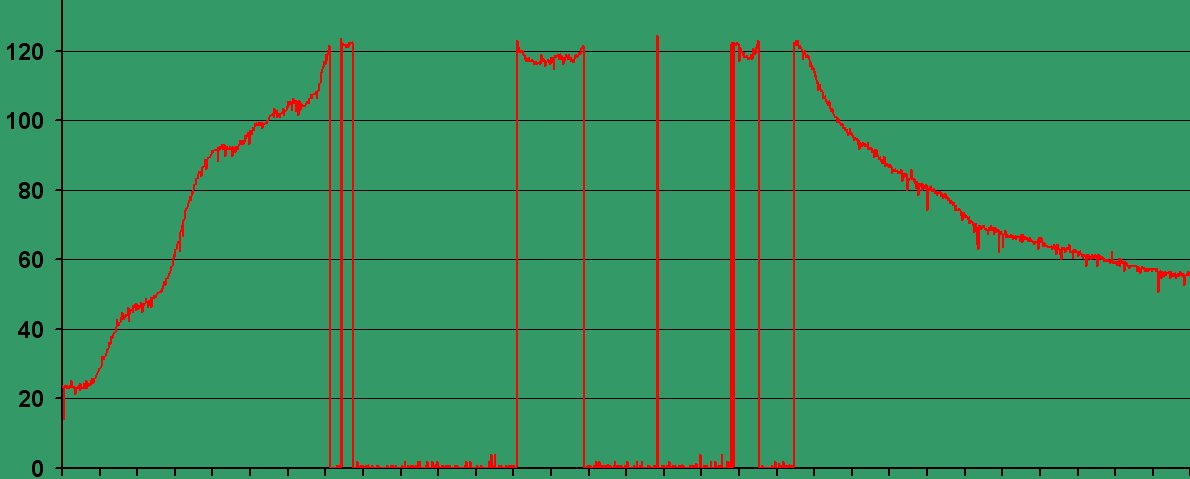

i have found a bug in my temperature logger (16F88 + 24LC512+LM35).
I works pretty well until it reaches temp values of 124șC, for values above it are displayed as 0șC or 0,5șC.
I've looked at my code and i think a know what the problem is: I need to separate the variable into lowbyte and highbyte.
