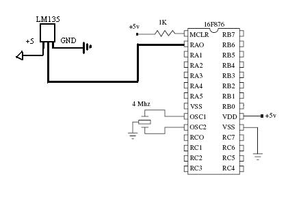

    Hi everyone,
    I'm trying to study a pic based thermometer using LM135 and PIC16F876A, but the display value is jumping from high to low, I think it has something to do with the voltage reference but I'm not really sure how it must be done. Please check my schematic and codes that I'm using.
    CLEAR
    DEFINE ADC_BITS 8
    DEFINE ADC_CLOCK 3
    DEFINE ADC_SAMPLEUS 50
    TRISA = %11111111
    ADCON1 = %00000011 ' Set PORTA.0,1,2,5 = A/D, PortA.3 = +Vref
    samples VAR WORD ' Multiple A/D sample accumulator
    sample VAR byte ' Holds number of samples to take
    temp VAR byte ' Temperature storage
    samples = 0 ' Clear samples accumulator on power-up
    LOOP:
    FOR sample = 1 TO 20 ' Take 20 samples
    ADCIN 0, temp ' Read channel 0 into temp variable
    samples = samples + temp ' Accumulate 20 samples
    PAUSE 250
    NEXT sample
    temp = samples/20
    Serout PortC.1, 6, [$FE, 1, #temp]
    samples = 0
    GOTO loop
    Thanks in advance,
    joe
