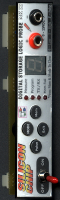

    Here's my first attempt with simple stuff using that method... long time ago. Sorry i don't have any decent camera here..
    http://www.picbasic.co.uk/forum/atta...5&d=1207242560
    Not sure how about Trent's method but looks good

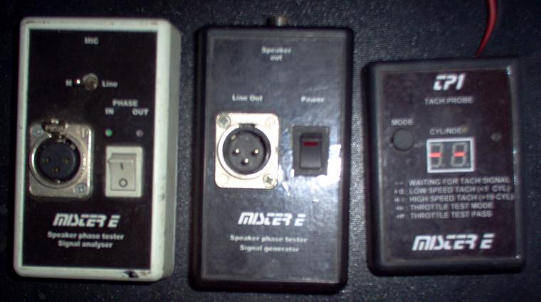

    http://www.picbasic.co.uk/forum/atta...8&d=1177475899

    It does look good. Also noticed u managed to cut a square in ur box for the seven segment display. Did u buy the box pre cut or use a dremel.
    That is my worst piece of work. Like a pig swimming around in jail cell in a puddle full s h i t.

    You can use Dremel, some kind of knockout punches (or punch and dies) or the ol' method... drill a hole, then shape it with files... i used punches and dies.

    Trent. your worst bit of work as you called it, looks quite good to me. What method did u use for that.
