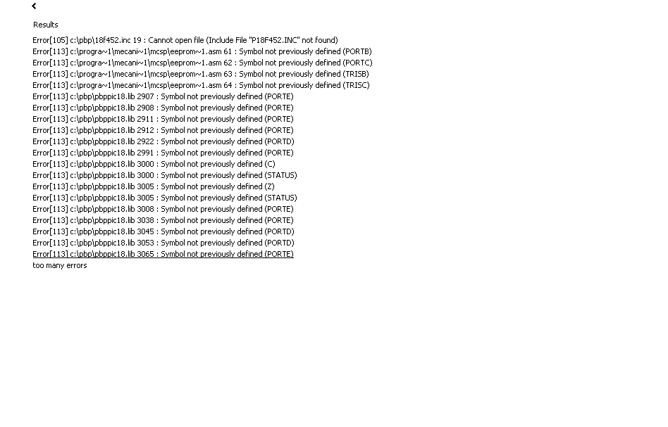

    Hi All
    I have been off programming for quite a while now and i am finding it really difficuit
    to get my 18F452 to program.
    i am using pbp 2.45 and Mplab V8.
    Each time i try to complier gives the following errors which i have attached.
    "Cannot open file (Include file "PIC18F452.INC" not found)
    it complies ok on 16F series thought.
    i know its something to do with the include file but i not sure
    Please help
    Isaac

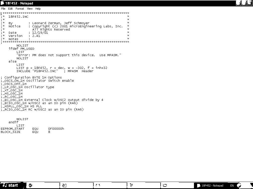

    I have also included the code i am running and the include file

    Hi, Zaac
    do you Use MPASM as an assembler ??? the Error file shows some MCS ...
    skimask's Avatar
    skimask Guest
    Doesn't that kick out a totally different error? Something like "18F not supported with PM" or something like that?
    3,648
    Hi, Ski
    You're right ... there's a window appearing in MCS if wrong assembler selected.
    the worst is the program compiles and assembles fine here ...
    Isaac,
    check : VIEW\Compile and Program options\ assembler tab and verify if good locations given.

    i have got it to compile now.
    Darrel Taylor hit the nail on the head .
    I pointed to it as he describe below andit worked
    In MCS, go to the View | Compile and Program Options | Assembler Tab
    Click the Find Manually ... button and point it to
    C:\program files\microchip\mpasm suite
    i thinkit was trying to use the mpasm that came with Microcode studio
    Thanks a million
    Isaac
