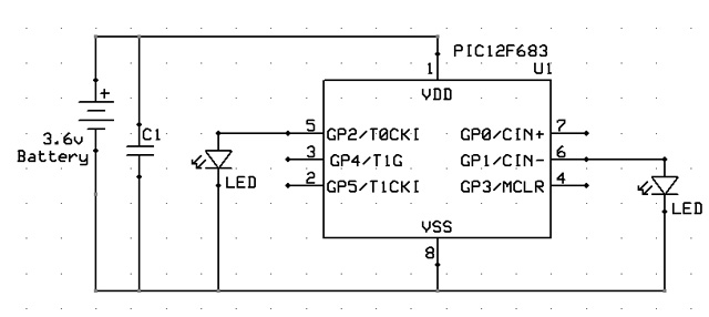

    Im trying to understand how this LED flashlight driver works, so I can implement the same technique on my own design.
    The driver is powered by a single 3.6v Li-ion battery and by powering it off-on in less than a second it changes modes: Hi 100% > Mid 35% > Lo 20% > Strobe > SOS
    Here is the link to it:
    http://www.dealextreme.com/details.dx/sku.6190
    AMC7135 Datasheet
    And here is the Schematic I drawn from inspecting the PCB:
    It obviously detects when power goes off, but I don't have the slightest clue on how its done, if I have to think of some PIC function that does that it would be BOD, but to be honest, Im lost.
    The capacitor in the schematic may work as a battery backup, but its rather small, so upon battery power lost the PIC must be configured to keep consumption to a minimum.
    Any help will be appreciated!

    But you must count while the power is out... there is no backup power. The mode is changed if you do an ON-OFF-ON cycle in less than a second.
    I Just updated the schematic to clearly show the entire circuit is battery powered with no backup power, reload the image so the new one is shown.
    Maybe Im missing something from your answer <scratching head>

    Quote Originally Posted by peu View Post
    YES !!!
    The capacitor holds enough power to the PIC not to reset all registers While you do the "quick on-off-on"
    remember V b.o.r. is more than the min running voltage of the Pic ... and driving your current sinks do not drain much current from the PIC ...
    so that gives enough time for the Pic to reset AND test the BOR Bit, change the mode, ... ... after that you re-apply the power ...

    I think I understand what you guys mean, this would be the metacode
    set BODEN config bit to 1
    set BOD bit to 1
    set POR bit to 1
    read level from eeprom / set level
    mainloop
    check for BOD/POR bits at PCON register
    if BOD=0 then wait for POR=0 and change to next level and write it to eeprom.
    goto mainloop
    Is this correct?
    I have some questions:
    What would happen if power is lost while writing to eeprom?
    Can this be handled with PBP without using interrupts?
    Regarding the cap, I don't have a oscilloscope to see the discharge curve, it seems to last around 1seg to fall below 2v but this measurement was done by the eyemeter.

    Im kinda lost again:
    From TABLE 9-6: INITIALIZATION CONDITION FOR SPECIAL REGISTERS
    PCON is initialized with %00000010 (POR=1 BOD=0)
    From 2.2.2.6 PCON Register
    REGISTER 2-6: PCON — POWER CONTROL REGISTER (ADDRESS: 8Eh)
    bit 0 BOD: Brown-out Detect STATUS bit
    1 = No Brown-out Detect occurred
    0 = A Brown-out Detect occurred (must be set in software after a Brown-out Detect occurs)
    From these datasheet entries I dont understand when BOD goes to 1

    I still have a doubt: when does the BOD bit goes from the initialization value ZERO (table 9-6) to ONE (No Brown-out Detect occurred) in a cold start scenario?
    At cold start the circuit should read the stored eeprom value not write a new one
    Feb 2005
    130
    Im reading different PIC datasheets so shed some light about the BOD sequence, but most of them share the same wording, Im really lost.
    I made a little proggie to test what I've learned in this thread, but it does not work, maybe Im missing something stupid, but after many hours of trying, maybe what I need is a good rest:
    @ device pic12f683,INTRC_OSC_NOCLKOUT , wdt_on, mclr_off, protect_off, bod_on
    CMCON0 = %00000111     ' Disable comparator
    VRCON  = %00000000     ' disable
    '       I/Os
    TRISIO = %00000000      ' no inputs
    ' definitions
    BODD var PCON.0
    gpio=%00000100            'I know program cold started
    pause 1000                'gpio.2 green led pin5 indicates coldstart
    gpio=%00000000
    loop:
    if BODD=0 then
        gpio=%00000010        'GPIO.1 red led PIN6 shows a BOD state
        gpio=%00000000
        BODD=1
    goto loop
    then the schematic is pretty simple, a ceramic capacitor at the power lines for storing some battery, a couple of leds at the specified pins and a momentary switch that allows me to cut VDD for a moment.
    It does not vork
    [edit] Maybe I need to check for POR=1 and BOD=0 to know for sure that a BOD reset happened
    Help!
    Here is the best reason ( may be others ... I must check ) for your gadget not to work ...
    THE DEVICE MUST DRAW AS LITTLE CURRENT AS POSSIBLE !!!
    Your led leads VCC voltage to ZERO ... so ... POR and not BOR !!!

    I will test this code as soon I arrive at my office:
    '       I/Os
    ' definitions
    ' init values
    if PCON.0=0 then
      gpio=%00000100            'Brown-out detected turn on LED on PIN5
      gpio=%00000010            'Brown-out NOT detected turn on LED on PIN6
    'main loop
    loop:
    goto loop
    I can't imagine simpler code to test the BOD function. Do you see something wrong?

    One thing to remember. The diode D1 is isolating the PIC supply from the LED. So the PIC should be able to stay in a brown out mode for a small amount of time. But your test circuit may have a problem if the indicator LED is directly connected to a PIC I/O pin. The LED may then drain the PIC power too fast and the PIC will go into POR quicker. The AMC7135 parts in the original design isolate the PIC pin enough so that it can still run off the cap charge. You need a higher impedance connection, on your test board, to the PIC to keep this from happening. Maybe you can put a buffer (like a HC04) between the indicator LED and the PIC pin and power the buffer straight off the supply.
    Also in your code, when you check the BOD, you also need to check the POR. This is because you will have one of two situations:
    BOD cleared but POR still set - Switch click
    BOD cleared and POR cleared - powered down
    Your code also needs to set both bits after they are checked, otherwise they will never be '1'. The hardware only clears the bits when a situation happens. It is the program's responsibility to set these bits.

    This is the circuit Im using:
    With this code:

    It does not work, the minute I give it power green lits and after 5 seconds¿?¿? it goes off and red lits.
    Am I missing something?
    I can use a 12F675 or even a 12F683 if a simpler / more efficient solution is possible.

    Change your test circuit as follows:
    Put a diode between the cap and the battery disconnect point like the sample schematic at the beginning of this thread has. This will isolate the PIC power from the rest of the circuit so that the cap will power the PIC when the battery is disconnected.
    Connect the LED cathodes to the I/O pins. Then connect the LED anodes to the battery disconnect point between the battery and the diode that was added above. By doing this, the LEDs won't draw power once the battery is disconnected.
    I wasn't that far with this late edit
    This works really fine, but with a 10 µ (MICRO) F ...and a 12F683
    so , some current draw improvements are still to add ...
    NOTE: All Outputs are Mosfet Buffered ( BS 170 ) ...
    PS: You didn't use your brain too much, here ....
    What brain?
    Well I implemented your program and it worked, but the cap value was way too high, so I started lowering till I found a ridiculously low value...
    Then I examined your code, removed some chunks and commented it:

    and if a picture is a 1000 words, we could say that a video is like 1000 pictures, so 1000x1000=1000000 words... WOW... I just wrote a book take a look at this video: http://www.veoh.com/videos/v6415763hQHpjMDy
    As you see, the cap is reaaally small, the green led shows BOD condition, and red led is normal operation. The diode you see there is not used. Also I left all the unused pins floating
    When I used large value capacitors, everytime I did a power interruption no matter if it was 1 second or 10 the BOD led turned on.
    I wonder why you had to use 10uF
    Also assembled a proto PCB using the 1st schematic to start testing a real world application.
