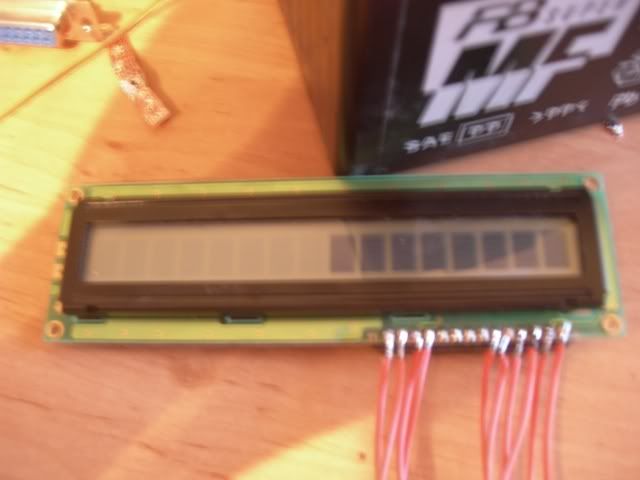

    I have salvaged an old 1x16 lcd from a phone, I am sure it is HD44780 compatible.
    I am using a pic16f628, but when I try the program all I get is this;
    Any ideas?
    TIA
    Hi TIA,
    Looks like it is working, you need to add a contrast control.

    I have a variable resistor for the contrast, all I get is those blocks though...

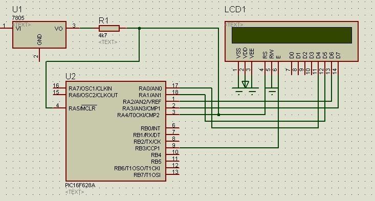

    I would add and the circuit also.

    Ah, I think that might be the problem, that is the whole code!
