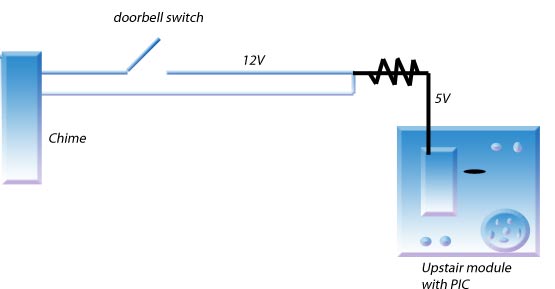

    I have installed a doorbell downstair, but it doesnt ring loud enought. So I taugh I would make a clever doorbell chime/lights with a PIC brain for upstair, as I don't really wan't to hear a loud thing all the time.
    So I extended a wire upstair, thinking I could tap into to signal serially just adding a resistor(it's 12v). uhhh.
    http://www.picbasic.co.uk/forum/atta...1&d=1201800699
    But then I realized I would never get anything from that setup, unless I would tap into the line serially with a relays.
    So I wonder know, is there a *simple*, electronic way(else than a relay) to get a 5v signal from that setup??
    Some kind of ghost current detection?
    thanks to the knowedgeables!
    Dom

    But if you want to learn electronics, try a voltage divider.
    http://www.pbpgroup.com/modules/wfse...p?articleid=25
    Italy
    695
    Try that.

    Jul 2007
    65
    Great,
    I'll see what I can do with opto or voltage divider(Once I grab components to try)

    Hey Joe S, I'll give a try to your idea, but actually I'd like to be able to tap in the signal like a spy, not having access to the ground signal.
    Rectifying the current sound interresting doh! If I tap 2 diodes to the thing, maybe I can get some DC current trace thru a wire??
    I'm really not a big fan of AC =)
