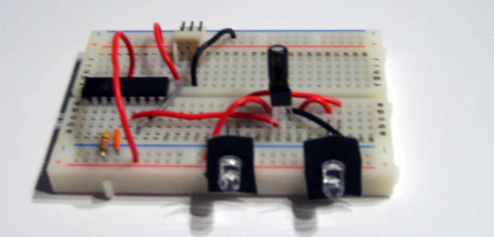

    Hi Techbuilder,
    Nice job building all of that.
    The layout and diode orientation is good.
    Glad to see the little light blockers on the back side of the LEDs.
    What type of IR diodes did you use?
    It looks like the diagram on the webpage agrees with the data sheet.

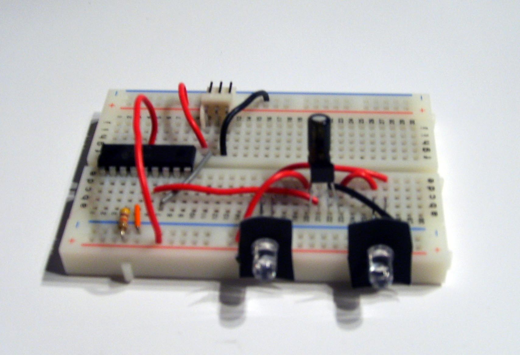

    Picture 3 looks like only the electrolytic capacitor is attached to pin 1 of the device.
    Is there a hidden wire from device pin 1 to V+ or is it missing?
    Also:

    Why thank you
    No there is no wire going to the positive, except that it is on the same row as pin 1
    should I connect it to positive?
    in his picture there was no wire going from the cap to positive.
    Also when I take the IR LEDS out the Green led is still on constant
    The IR LEDs are the ones that were put on the site
    they are Fairchild QED234 Infrared LEDs that I purchased from digi key.
    The only things that I used different was the radial electrolytic cap instead of the ceramic.
    But it was still rated at 0.33uf

    Wink "Do as I say, not as I do" old saying...
    Quote Originally Posted by Techbuilder View Post
    Why thank you
    The capacitor substitute should be fine in this application. Just be aware of the polarity.

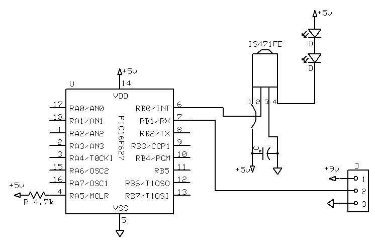

    I agree the picture on the web page looks like there is no connection from (the junction of pin 1 and the capacitor) to 5V+.
    Here are other clues to the contrary.
    Garrett Hamilton–Smith, Raihan Khondker, and Will Norris
    "Connect the Cathode of D1 and pin 1 of the IC to same common point to be connected to +5V."
    <IMG SRC="http://www.picbasic.co.uk/forum/attachment.php?attachmentid=2350&stc=1&d=120257342 8">

    Cool I got it working!!!!
    Yay now I am one step further to completing the automatic toilet flusher.
    Thanks Pic_User

    Question pin 3 or pin 1
    Thanks, the reason it wasn't working was because pin 3 was not going to positive so for some reason the led kept being on but once I supplied the 5 volts + to pin 3 it worked.
    Hi Techbuilder,
    Do you mean pin 3, or pin one (1) to plus (+)?
    <IMG SRC="http://www.picbasic.co.uk/forum/attachment.php?attachmentid=2351&stc=1&d=120266867 7">
    -Adam-

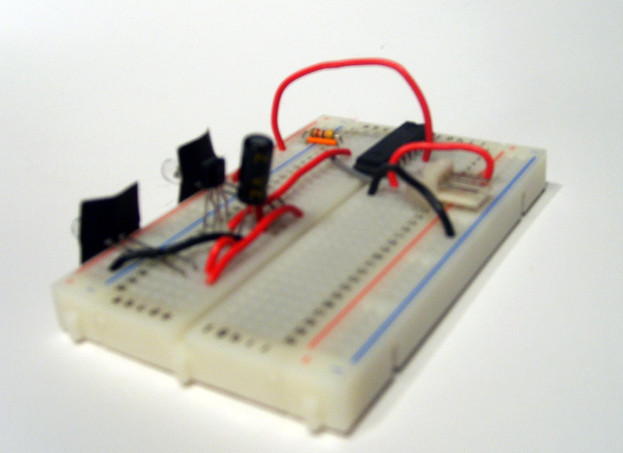

    Here's the final bread board
    Maybe I am missing something I don't know
    maybe you can point it out.
    I used a 16F627A
  17. #57
    Apr 2006
    New Hampshire USA
    298
    Thumbs up Should work...
    I used a 16F627A
    Looks good.
    I didn’t check the PIC pin-out, expect you did that.
    Looks like a 4.7k (4k7) resistor to +, on a pin probability MCLR = good.
    Should work.
    But:
    You should have a ceramic or low inductance capacitor, right close to the PIC, between power pins. About ~ 0.1 microfarads.
    I always put an electrolytic capacitor on the +/- “rail” (power) where it comes onto the solder-less bread board. About ~ 100 microfarads.
    It would not hurt to put another electrolytic capacitor on the same power pins as the previous ceramic. About ~ 10 to 100 microfarads. Yes all the capacitors are in parallel which seems strange to beginners. You will get the idea as you start to learn about faster circuit dynamics…
    Also, I like to hang an LED with a current limit resistor on the power rail. This helps us avoid “dumb time”, when the power is off and the green trigger LED will not come on no matter how many things we try.
    Disclaimer: This is something I have heard about. I have NEVER had this happen to me.
    -Adam-

    Ok, Well here is the schematic.....
    There is a possibility it is the servo but I changed the software to turn on a LED when the proximity sensor is active and nothing.
    So it's either the circuit or the software
    but take a look at the schematic down bellow
    to see if I might of forgot something crucial.
    My guess is that it is the program, but it might be the interface from the sensor to the pic

    It is connected to pin 1 and 3 of the IR IC which is in the schematic
