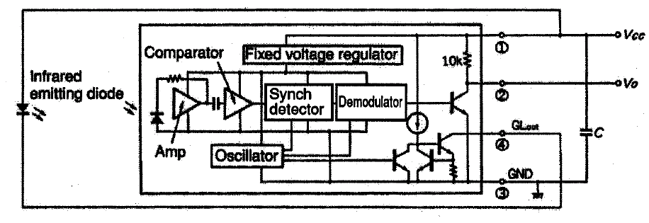

    That's kind of want to do
    What I want is just an IR sensor that reads when a hand has been passed by it and turns the servo all the way to the left (or right) and flushes the toilet.

    Some ideas about this here:
    Infrared Proximity Sensor
    http://www.g9toengineering.com/AllSa...dproximity.htm
    -Adam-
    Jul 2007
    67
    Quote Originally Posted by Pic_User View Post
    -Adam-
    This is exactly what I am talking about
    but how hard would it be to interface with a PIC?

    Quote Originally Posted by Techbuilder View Post
    Hey Pic_User or anyone
    Is it difficult to interface the that link that you gave me to a pic?
    All I want it to do is when it comes in contact, to rotate the servo all the way to the right or all the way to the left.
    Hi Techbuilder,
    search Google:
    IS471FE
    Find this (second hit):
    http://document.sharpsma.com/files/L...ce-opic_AN.pdf
    On this Sharp application note:
    Light Detecting Device-opic
    Search for:
    IS471FE
    Page 5 tells us:
    the parameters of the IS471FE
    Page 24 shows us the internal / external hook-ups of the IS471FE
    <IMG SRC="http://www.picbasic.co.uk/forum/attachment.php?attachmentid=2326&stc=1&d=120200443 9">
    Mostly it looks like it will operate with 5V DC input.
    It has “open collector” output.
    It has a built in 10k “pull-up” resistor.
    so it LOOKs like you could use a circuit like this:
    <IMG SRC="http://www.picbasic.co.uk/forum/attachment.php?attachmentid=2325&stc=1&d=120200428 1">
    Thanks to:
    Garrett Hamilton–Smith, Raihan Khondker, and Will Norris,
    School of Information Technology and Engineering, University of Ottawa
    -Adam-

    Thanks, would it be hard to compile a code to detect using this method?
    Apr 2006
    New Hampshire USA
    298
    Default like a push button
    Hi Techbuilder,
    You could consider the module like a push button. Your program would need to watch for a low or 0 (zero) to know someone / some thing had come close to the sensor module.
    -Adam-

    Something is wrong with my proximity sensor
    When I was done setting up the circuit on this website my led was on constanly
    Here's some pictures of my bread board
    Jul 2007
    67
    Here's the data sheet, I think the people that design the circuit got the pins wrong
    http://www.alldatasheet.com/datashee...RP/IS471F.html
    I don't know maybe you can help me out
    Can not see very well from your pictures, but it looks like the cap is connected to the IR and can not tell where the LED is connected.
    Make sure every thing is like it is on the last page of the data sheet.
