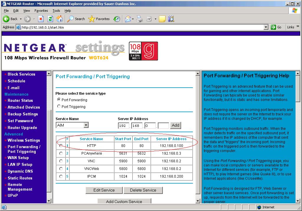

    I think the screen your in is for a Static Route. I take back what I said earlier.... I'm using a NetGear router. Here's what mine looks like.

    Althought this page was made for an internet file sharing program,
    the part about port forwarding in the d-link should be the same.
    http://portforward.com/english/route...4T/Azureus.htm

    4,174
    OK Darrel. That is what was needed! I will try and see how it goes.
