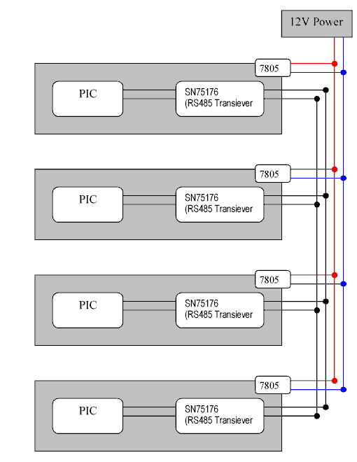

    I will be using the RS485 Interface and just want to make sure that I'm on the right track (See Attachment)?
    I want to make use of 4 twisted pair cables, 2 for the Serial comms between the stations and 2 for the power (don't know if 12volts is too much?)
    The Base station (Top) will continually ask each station it's status. When it receives a reply or reach a timeout it will move on to the next one.
    The cable length between the stations will be about 20 meter (65ft) and I rather want a reliable connection than a fast one.

    That exactly was the idea that had implemented long ago using standard UTP cable and distributing power through the free pairs to the slave devices. My setup had 1 master and up to 4 slaves at very slow speeds. But when all 4 slaves were connected, one was loosing communication from time to time. I have not found why up to this moment.
    I am suspecting that the bus is at 3-state when no device is active and this is producing an error.
    I used the ADM483EAR chip instead of SN75176 because of the fail safe protection. On a recent system I returned to the good old 176 and everything is cool. I added external resistor for the fail safe protection though.

    We did something similar a few years ago, except that instead of running two twisted pairs we used 18 gauge thermostat wire for the power, and ran 24 volts alternating current, supplied by a standard HVAC transformer. Each node then had it's own 7805. The SN75176 requires about 30 milliamperes for itself, plus the PIC and any additional circuitry. We kept the power wire separated from the data wire as much as possible. Some of our runs exceeded thirty meters between nodes, and voltage drop was noticible when using a smaller gauge wire.
    Parallax has a nice little application note available at;
    http://www.parallax.com/dl/docs/prod...munication.pdf
    They also have an example program written for the Basic Stamp that should get you started. If you keep your data rate low you may get away without terminating resistors, but anything above around 9600 baud and you will likely need them.
    Jerry.
