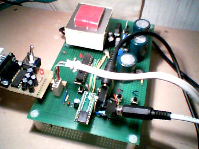

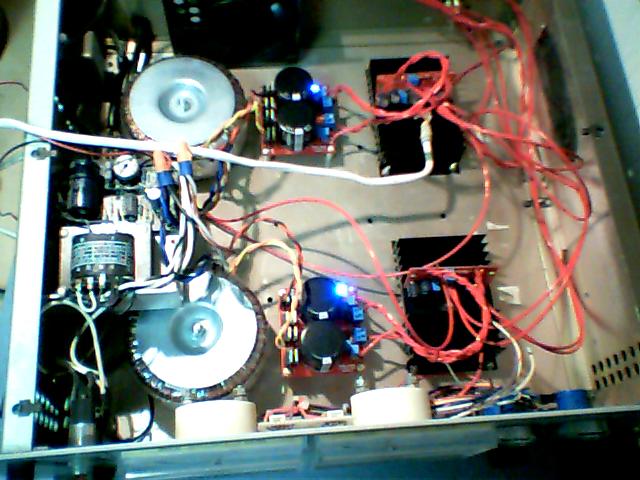

    I wish I had seen this thread earlier as I would have given a thumbs up for the PGA2320 Volume control chip from TI. I have one of them running my Gainclone amp and couldn't be happier with it although I don't consider myself an Audiophile by any means.
    I control it with 3 pushbuttons, increase gain, decrease gain and a third for Mute, all running from a 16f876.
    Here are a few pictures.
    The first is the PGA in action. The thing to the left is a programming dongle I use to cram stuff into the bootloader and the heavy white wire goes to a LM34 to take the temperature of the Amp chip.
    The second is of the amp itself, a dual mono.

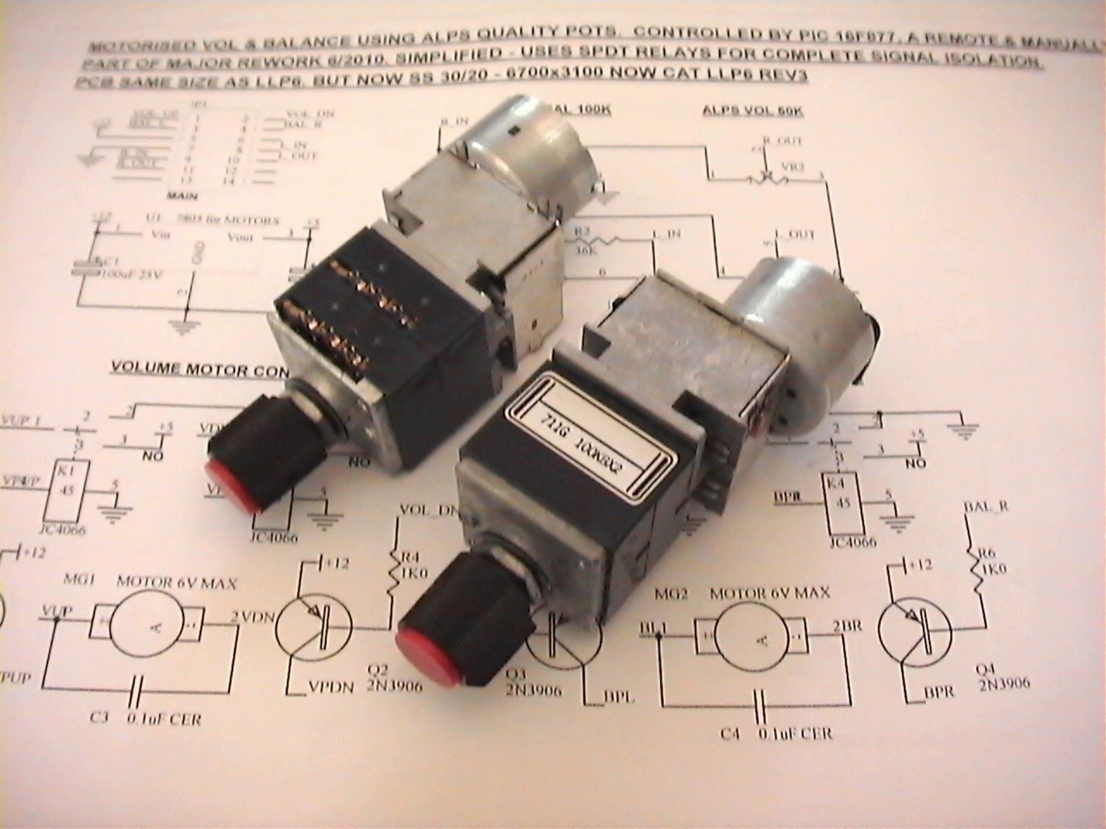

    I agree with the posts here regarding the noise introduced by digital volume/balance controls. Have used many but mainly the Dallas DS1809 stereo chip. No matter what you do with support circuitry including the suggested bridge there is still a lot of noise if your aim is top quality sound.
    So I went back to normal pots. Used Alps with motors for both volume and balance. There seems to be a move not to include a balance control for various sonic reasons. I find it essential as my recordings vary all over the place and I like the vocal "middle sweet spot". I have now settled on the circuit here - it's about try 7 I guess. Simple but good.
    For my new tube pre-amp all functions and the two displays are controlled by a single 16F877 PIC. This is what it controls.
