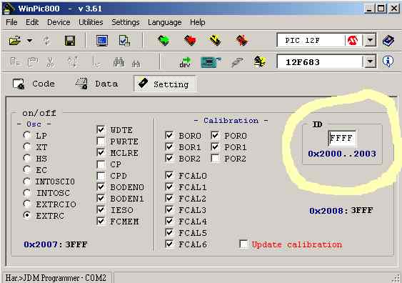

How do I write to the User ID memory locations (2000h-2003h) on a PIC 12F683? Poke, PokeCode, Write, and WriteCode don't seem to be the answer. Do I need to insert assembly code in the PBP code?

place those line at the end of your code
you should haveCode:asm errorlevel -220 org 0x2000 dw 0,1,2,3 endasm
ID0 = 00
ID1 = 01
ID2 = 02
ID3 = 03
Probably there's a much more elegant way to do it... seems to work here

deuhhh, yes there's an easier way.... Always nice to read MPASM PDF
Neat, easy, and it works!Code:@ __IDLOCS 0x1234
EDIT:But seems the previous allow much possibility...you could set 1A, 1B, 1C, 1D.. not with the second.. or i overlooked something... as usual![]()
