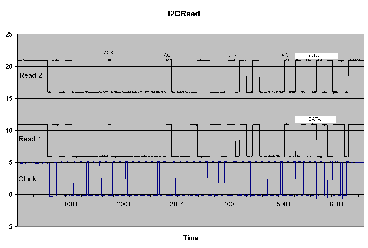

    I need help getting I2CRead to work. I am using an 18F4620 running at 4 MHz and a 24LC65 serial eeprom. I can write data to the eeprom but I can not read the data back out. I have an oscilloscope connected to the clock and data lines of the eeprom and I can see that it is sending data back to the pic. The data bus is two way and I can see both the data sent to and from the eeprom, see the attached file. The returned value of Data1 is always 0. What the hey?

    Also, without the schematic I can only point some area for you to check:
    -Since I2CDevice = $A0 = %10100000, you should make sure the A2,A1 and A0 pins of your EEPROM are at Vss (Ground)
    -Are you using pull-up resistors on SCL and SDA line ?
    -Did you make sure you turned off analog mode for SDA an SCL pins you're using? (if applicable)

    "-Did you make sure you turned off analog mode for SDA an SCL pins you're using? (if applicable)"
    Oh gee, that was bright. Thanks guys, I added ADCON1 = %1010 to make PortE a digital port, its analog by default, and it is working. I can't tell you how long I looked at that without seeing the light.
