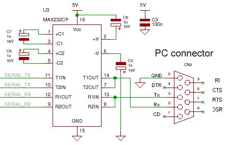

    I found a diagram on the net. Ive modified it to how i think it should be for my circuit. (See attachment).
    Is that diagram correct?
    Which chip do i use? :P (back to that question) I think its one of the chips on this page. Im not completely sure but the one that looks right to me is the "MAX232CPE+ CMOS DUAL RS232TRANS/RCV RC" Order code: 82-0148.
    And for the caps, will this one do? The diagram says 1u 16V and that one is 50V but i dont think that matters

  15. #55
    MAX232 is what you need, you could still use a simple transistor/mosfet as inverter. for short distance that's good enough. Here's one of the various transistor solution available over the net
    http://www.piclist.com/techref/io/serial/ttl2rs232.htm
    The ICSP diagram might work or not depending of your programmer, Microchip have an ICSP guide
    http://ww1.microchip.com/downloads/e...Doc/30277d.pdf
    there's also the usual Melabs schematic bellow:
