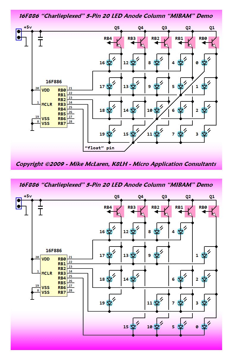

    Someone asked about the diagonal line on my Charlieplexed display sketch. It's what I refer to as the "float" pin and it's connected to the LEDs that occupy positions in the matrix that would otherwise share a common column and row (RB0/RB0, RB1/RB1, etc.).
    I apologize if the diagonal line has thrown you off. It's a remnant from some of my sketches of Charlieplexed 7-segment displays.
    Both drawings below are electrically the same but the second drawing below may make more sense. Basically I just slid those LEDs in the bottom row up into the empty spaces in the matrix.
    Kind regards, Mike

    Hi Mike,
    I wholeheartedly agree.
    MIBAM with multiplexed display doesn't seem like it's worth it, because you loose so much of the available dutycycle.
    Thanks for the explanation of the diagonal line.
    I did get your example working, with only 8 leds (2 columns).
    I made enough changes to not know if it's actually the way yours works or not.
    But I don't see a way to incorporate it into the MIBAM routines (because of the duty cycle losses), so I'm officially tossing Charlie out the window.

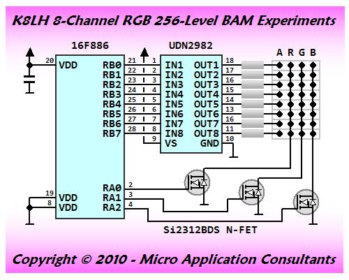

    Yes, LED duty cycle is decreased with any multiplexed display and while we normally pump up the "peak" current to get better "average" current (and brightness) we can't do that with a Charlieplexed display (or any other multiplexed display that uses "direct drive" for matrix columns or rows).
    Anyway, I thought you might enjoy taking a peek at a multiplexed 8-channel RGB display demo' (24 discrete LEDs) with 256-level BAM driver and a pretty amazing 868-Hz refresh rate. The display is fashioned as a 3x8 matrix (33% duty cycle) so biasing the LED "peak" current to approximately 3x desired "average" current will be necessary. This assembly language program just contains the driver. No animation or anything like that, yet.
    Regards, Mike

    Can anybody mail me a code for charliplexing more than 20 or even 20 LEDs with 16F886 in a C listing file ?
  31. #151
    Sep 2010
    Las Vegas, NV
    305
    Default Re: Bit Angle Modulation (BAM) in a PIC
    There are several posts encompassing a 20 LED charlie and at least one using only 4 PIC pins.
    I doubt though you'll find any of them in C and I guarantee you no one will do it for you.
