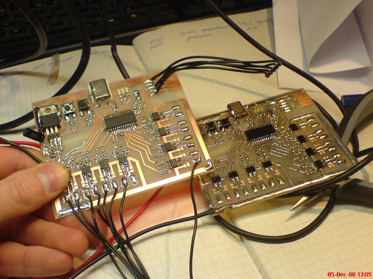

    ten days ago. i try the bam, find from 127 to 128, the led blink.100Hz, 8bit.
    i know it is change so much. so i find ur post and i send some post to urs.
    last week, i let it to 2.4kHz, bam. the led will not blink.
    i don't test ur mibam, i think it is good.
    i use pic18, and 48 dmx512 channel. 2.4kHz bam 8 bit.

    I have working code for 14bit 610hz BAM with 16 output PWM channels (code could be updated to get more channels with external logic if needed), but i didn't tried to resolve flicker problem with BAM yet. I think that simple signal mirroring doesn't help to fully avoid flicker(s), it just makes it significantly lower, but maybe also affects visual perception of signal "decreasing" actual refresh rate. And there are other ways to avoid flicker trouble, too. However, MIBAM is very good approach, thanx to it's simplicity in combination with reasonable effectivity. Thank You, Darrel Taylor & RadikalQ3 for giving good explanations and usefull thoughts. Btw, additional advantage of MIBAM method is that it might slightly reduce level of generated EMI.

    It's amazing how many people have come here to tell me that the Mirror Image won't fix BAM's blinking problem.
    With the mirror image, there is absolutely NO blinking AT ALL. (Not even with a video camera).
    Of course everyone admits that they've never even tried it.
    But yet they still feel it's ok to tell the world that it won't work.
    All I can do is return the favor ...
    16 channel, 14-bit BAM, at 610hz, with a PIC, is IMPOSSIBLE.
    It was bad enough when you said 13-bit. But now with 14-bits, the minimum period would be 0.1 µS. There's NO WAY you can set 16 outputs to the desired states with only one instruction, then set them all to new states on the very next instruction.
    But then ... "I've never tried it".
