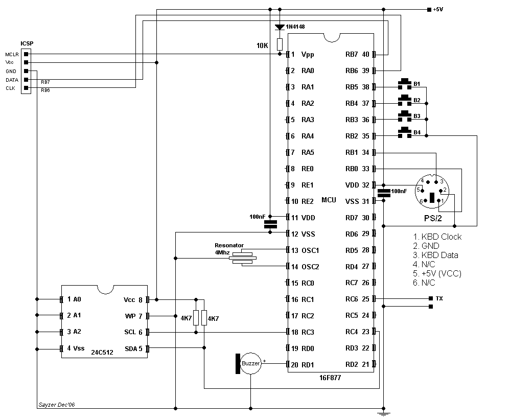

    As dhouston mentioned, you should design your circuit compatible with ICSP connector.
    Attached is an example for on-board programming operation.
    You can easily get the idea how it works.
    Only thing to pay attention for is to isolate programming pins from the rest of the circuit.

    Looking at your schematic... there's no resistor and diode on the MCLR/VPP line. compare your schematic with Sayzer's one o rthis one on the Melabs website...
    Reading the support page on the ICSP the diode and resistor are only for the protection of other components.
    "If 13V on the MCLR pin might put at risk other components on your board, use a diode in series with the RESET pullup to keep the 13V off of the Vdd line."
    mmm... yes but MCLR have to be 13 volt to program the PIC... so let's say your programmer is strong enough to power up everything... your Vdd rail willl be 13Volt and blow everything --- and this include your PIC ----
    also make sure the PGM pin is loaded to GND via a resistor or anything else.
