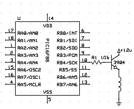

    thanks, the info you've provided is greatly appreciated.
    Does this look like the hardware necessary for connecting an IC to a relay? or is there potentional for failure here?

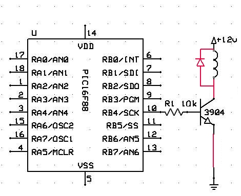

    Try this.
    12 V relay coil?
