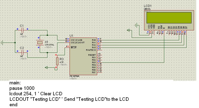

    Hi experts,
    I'm a beginner in PBP and Proteus, can u tell me is there something wrong with my connections, I just want to display "Testing lcd". Please check my circuit below.
    Thanks in advance,
    Joe
    51
    Looking at you drawing I can see 2 things wrong
    The RW pin needs to go to ground
    and your RS pin need to be connected to the pic dependig on which pin you have got declared in your code
    Oct 2003
    holland
    251
    I see 1nF as C1 and C2 near the xtal.
    That value is much too high for a xtal. you should change it into 47 pF for both capacitors.
