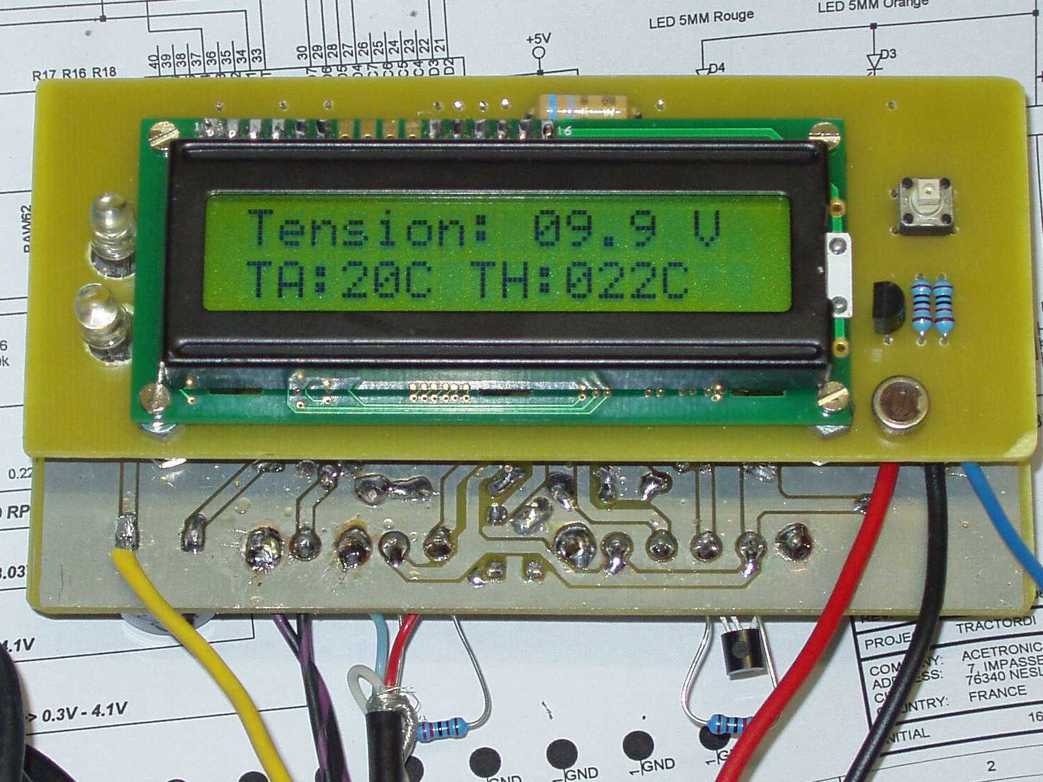

    I'm working on a "yellow metal" LCD display dashboard, it took me a very very long time so far ( years ) and is finally ready for a test ride.
    In order to improve on the hardware diagnostic ( broken wire warning etc ...)
    I still remain with a problem that has me shaking my head.
    When the microcontroller is started without a connection to the tempval = adin 1
    see tempcalc: then it does not display the results from adin 2 and adin3
    namely the battery voltage and the oil pressure warning light.
    I would like to improve the program so it can diagnose and display all hardware problems
    as much as possible

    a picture when all goes well
    www.skidloaders.co.za/pic/LCDdash1.JPG
    a picture when wire of temperature gauge is not connected
    www.skidloaders.co.za/pic/LCDdash2.JPG

    Try something like
    If tempval = 0 then go someplace else
    Or do an IF THEN ELSE at the end of the tempval block.
    It looks like the program is stuck waiting on "tempval".
    after all the calc routines theres goto tempdisp but for the tf routine you have goto loop. never gets to temp display.
