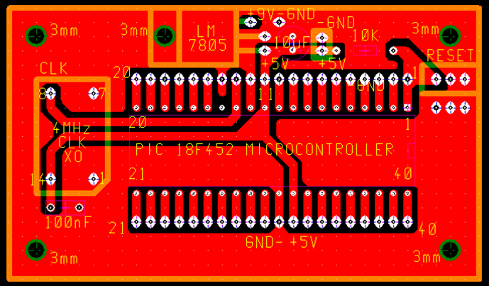

    Could be interesting to have your whole schematic.
    Red face updated
    there is no pot on the board that i got. The lcd and keypad was preassembled by my instructor. trying to get a picture and or the schematic but dont have that at the momentThe pic he used was his daughters and it was the same as mine Pic18f452 and was demostrated that it work on the board that i have trouble with.
    I would like to take the time and say thank you for helping. Its some of the most help i got so far with this.

    Please provide a drawing showing how the LCD is connected (draw it on paper and scan it if you have to)

    Here is what I see:
    I see no config fuse settings in his code.
    I see a circuit board set up to use an oscillator module, not a crystal or resonator, so it would seem necessary to set fuses for External oscillator. Keypad code looks VERY FAMILIAR, like something mr_e once tossed together so I am pretty sure it is tested and working. In conclusion, I believe you need to work on your config settings, which should contain statements about _CONFIG1 EC_OSC and WDT_OFF etc . . .
    look at this data sheet.
    http://ww1.microchip.com/downloads/e...doc/39564b.pdf
