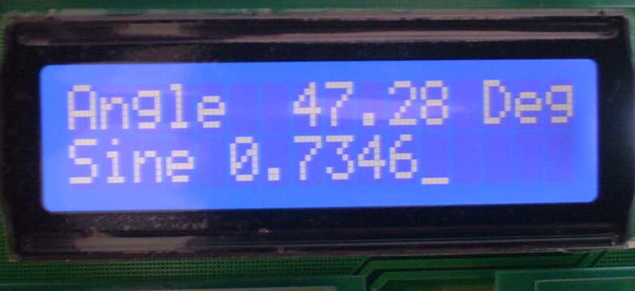

    Here we go... third method of getting accurate Sines... no DIV32 statements, accuracy to at least three decimal places and 99% of the time you'll get four decimal places... near instant calculation etc etc... also brews Cappuccino, Late and Expresso on the side...
    Yes, with simple PBP we take an ANGLE to TWO DECIMAL PLACES (what? decimal places with integers?) and produce an example of SINE to FOUR DECIMAL PLACES... who need floats when you've got integers?...
    Example 1.
    Sine of 135.57 Degrees
    Result 0.7000
    Actual 0.700037341
    Example 2.
    Sine of 45.25 Degrees
    Result 0.7101
    Actual 0.710185375
    Example 3.
    Sine of 186.66 Degrees
    Result -0.0638
    Actual -0.063836616
    Do NOT get worried about the size of this code... the ONLY important bit is the CalculateSine subroutine and the EEPROM statements, the rest is window-dressing to make pretty displays and for easy data-entry.

    	'	Start Program
    		'	Initialise Processor
    	TRISA=%00000001
    	TRISB=%11111111
    	TRISC=%00000000
    	OPTION_REG.7=0			' Enable Pull-Up's
    	Pause 1000
    	Angle=0
    	'	Enter Data
    	'	This section gets variable ANGLE
    	'	ANGLE is a value 0-36000 where 36000 represents 360.00 Degrees.
    	'	Press UP/DOWN Buttons to set the Angle 0-360, then Press SET to Accept the value
    Loop:
    	LCDOut $FE,$01,$FE,$0E,"Angle "
    	Gosub DisplayAngle
    	LCDOut " Deg"
    	UserPos=0
    	Gosub UserEntry
    	If Angle>35999 then
    		LCDOut $FE,1,"Angle must be",$FE,$C0,"less than 360.00"
    		Pause 1000
    		goto Loop
    	'	Calculate & Display SINE
    	' 	This section gets and Displays the resultant variable SINE
    	Gosub CalculateSine
    	LCDout $FE,$C0,"Sine "
    	If SineNeg=1 then LCDOut "-"
    	LCDOut #SINE DIG 4,".",#SINE DIG 3,#SINE DIG 2,#SINE DIG 1,#SINE DIG 0
    	'	Loop around again (Press SET to Continue)
    	While KeyBut<>3:Gosub GetKey:Wend
    	LCDOut $FE,1
    	While KeyBut<>7:Gosub GetKey:Wend
    	Goto Loop
    	'	Subroutine Calculates Sine
    CalculateSine:
    	SineNeg=0
    	If ANGLE>18000 then SineNeg=1	' Determine if negative Result
    	TempA=Angle			' Reduce angle to 1st Quadrant (0-90 degrees only)
    	If TempA>17999 then TempA=TempA-18000
    	If TempA>9000 then TempA=9000-(TempA-9000)
    		'	Load Low-End of Lookup
    	CounterA=TempA/100
    	If CounterA=0 then
    		SineMin=0
    		If CounterA=90 then
    			SineMin=10000
    			TempB=CounterA*2-2:Read TempB,SineMin.Highbyte
    			TempB=TempB+1:Read TempB,SineMin.Lowbyte
    		'	Load High-End of Lookup
    	CounterA=CounterA+1
    	If CounterA=>90 then
    		SineMax=10000
    		TempB=CounterA*2-2:Read TempB,SineMax.Highbyte
    		TempB=TempB+1:Read TempB,SineMax.Lowbyte
    		'	Determine the Decimal Fraction (Interpolation) Bit
    	TempB=TempA-((TempA/100)*100)
    	Sine=SineMin+(((SineMax-SineMin)*TempB)/100)
    	'	Subroutine Reassembles User-Entered Angle
    ReassembleAngle:
    	Angle=UserData(0)*10000
    	Angle=Angle+(UserData(1)*1000)
    	Angle=Angle+(UserData(2)*100)
    	Angle=Angle+(UserData(3)*10)
    	Angle=Angle+UserData(4)
    	'	subroutine Displays Angle
    DisplayAngle:
    	LCDOut $FE,$86,$FE,$0C
    	If Angle>9999 then
    		LCDOut #ANGLE DIG 4
    		LCDOut " "
    	If Angle>999 then
    		LCDOut #ANGLE DIG 3
    		LCDOut " "
    	LCDOut #ANGLE DIG 2,".",#ANGLE DIG 1,#ANGLE DIG 0
    	'	Subroutine Scans Buttons
    		' KeyBut - 0 = Invalid (SET+UP+DOWN Pressed)
    		'	 - 1 = Invalid (SET+UP Pressed)
    		'	 - 2 = Invalid (SET+DOWN Pressed)
    		'	 - 3 = SET Pressed
    		'	 - 4 = Invalid (UP+DOWN Pressed)
    		'	 - 5 = UP Pressed
    		'	 - 6 = DOWN Pressed
    		'	 - 7 = No Buttons Pressed
    GetKey:
    	KeyBut=0			' Zero any previous Result First
    	KeyBut.0=ButtonDown		' Read Input Buttons
    	KeyBut.1=ButtonUp
    	KeyBut.2=ButtonSet
    	Pause 100			' Allows for 10cps auto-repeat
    	'	Subroutine performs User Numeric Field Entry
    UserEntry:
    	For CounterA=0 to 4
    		UserData(CounterA)=Angle DIG (4-CounterA)
    		Next CounterA
    UserEntryLoop:
    	CounterA=$86+UserPos
    	If UserPos>2 then CounterA=CounterA+1
    	LCDOut $FE,CounterA,$FE,$0E
    UserEntryLoopSkip:
    	Gosub GetKey
    	UserMax=9
    	If UserPos=0 then UserMAX=3
    	If KeyBut=5 then
    		UserData(UserPos)=UserData(UserPos)+1
    		If UserData(UserPos)>UserMAX then UserData(UserPos)=0
    		gosub ReassembleAngle
    		goto UserEntryLoop
    	If KeyBut=6 then
    		If UserData(UserPos)=0 then
    			UserData(UserPos)=UserMAX
    			UserData(UserPos)=UserData(UserPos)-1
    		goto UserEntryLoop
    	If KeyBut<>3 then goto UserEntryLoopSkip
    	UserPos=UserPos+1
    	If UserPos<5 then goto UserEntry
    There you go... with only 178 EEPROM statements you've got 36,000 points on your Sine graph.
    Have fun...
    Melanie
