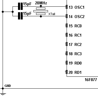

    Pins 13 and 14 never connect to ground, the capacitors connect between these pins and ground.
    Jan 2006
    Istanbul
    1,185
    Something like this....
    <IMG SRC="http://www.picbasic.co.uk/forum/attachment.php?attachmentid=2022&d=1190186888
