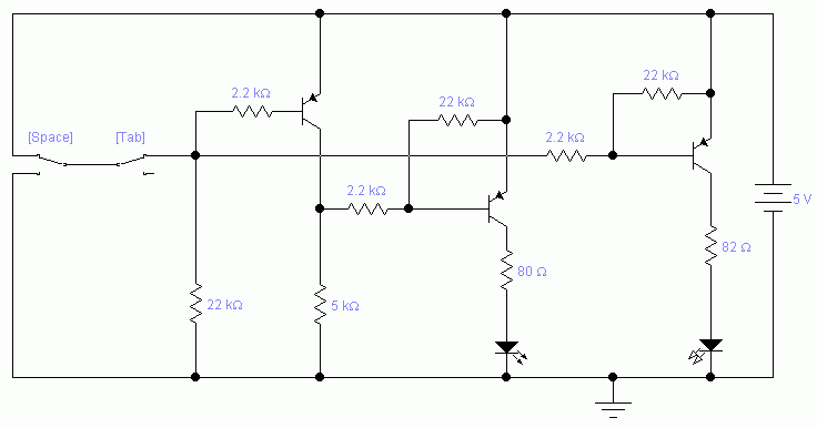

    I was just wondering if something like that could work.
    <img src="http://www.picbasic.co.uk/forum/attachment.php?attachmentid=1986&stc=1&d=118926122 9">

    Just to throw a little confusion in the mix, .... how bout ....
    <table border=1><tr><td><img src="http://picbasic.co.uk/forum/attachment.php?attachmentid=1994&stc=1&d=118930280 7"></td><td>
    Or, it may need a normal NPN
    <img src="http://picbasic.co.uk/forum/attachment.php?attachmentid=1995&stc=1&d=118930343 1"></td></tr></table>
    Also just on paper
    <br>
