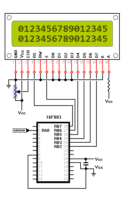

    Schematic attached.
    (Note that in the code I'm not doing anythng with the sensor yet, and it's disconected from AN0 right now)

    Just curious why you have LCD Data on RB2,3,4 & 5. If you simply moved them up two pins and moves E and RS down, you could use the standard PICBasic product with no modifications. I can understand if you have a PIC which doesn't have four consecutive pins available on a port, but why go to all the inconvenience when there is no need?
  12. #52
    In your code above, you have MCLRE enabled.
    But in the schematic you don't have a pull-up on MCLR (Pin 1).
    <br>
    I'll try adding that, thank you. I'm sorry to keep bugging you about this.

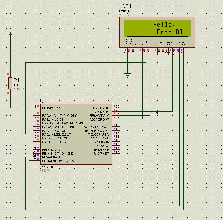

    I touched nothing on your code.
    Just compiled it as is.
    And it works with no problem as seen in the simulation (attached).
    http://www.picbasic.co.uk/forum/atta...1&d=1259222341

    Quote Originally Posted by sayzer View Post
    Actually I see you have a pull-up on pin 1 and also have pin 7 tied low.
    I don't see how pin 7 can be any problem for me but looking at the PCB I notice it doesn't have the pull-up on pin 1.
    Existing (pre-programmed) 16F883's I have on my bench are working fine when inserted into this PCB so I have reservations thinking that's the problem at hand.

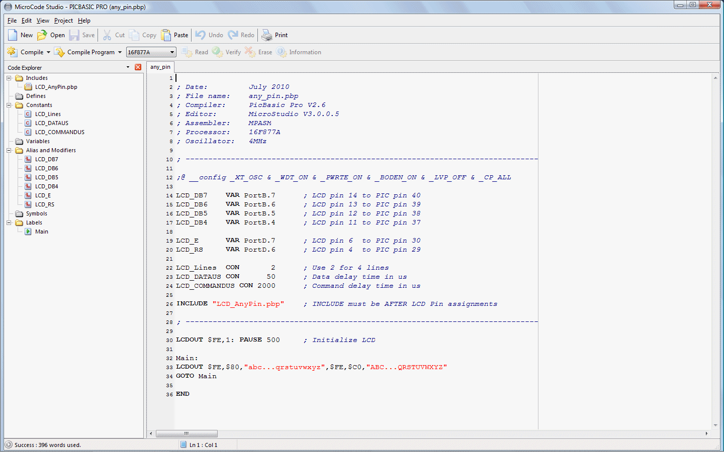

    Darrel,
    Top thanks to you for sharing such nifty code. Like your Bargraph code, I got it to work first time.
    If by chance that you are still running this thread, would you perhaps let me know what I'm doing wrong when I hook all 6 LCD lines to the same Port? It works fine when I hook E and RS to separate Ports.
    This is my first time with MPASM. I had to comment-out the config line, else it doesn't assemble.
    Thanks again.
    Respect for knowing all what you know about PICs.
  23. #63
    Hi Peter,
    I'm not sure what the problem is, but I ran your program on a 16F877a with all the LCD pins on PORTB, and everything worked fine.
    Although, with the pinout you are using ... you don't really need the LCD_AnyPin program (the data bus is on RB4-7).
    For the config error, see this page ...
    http://melabs.com/support/config_defaults.htm

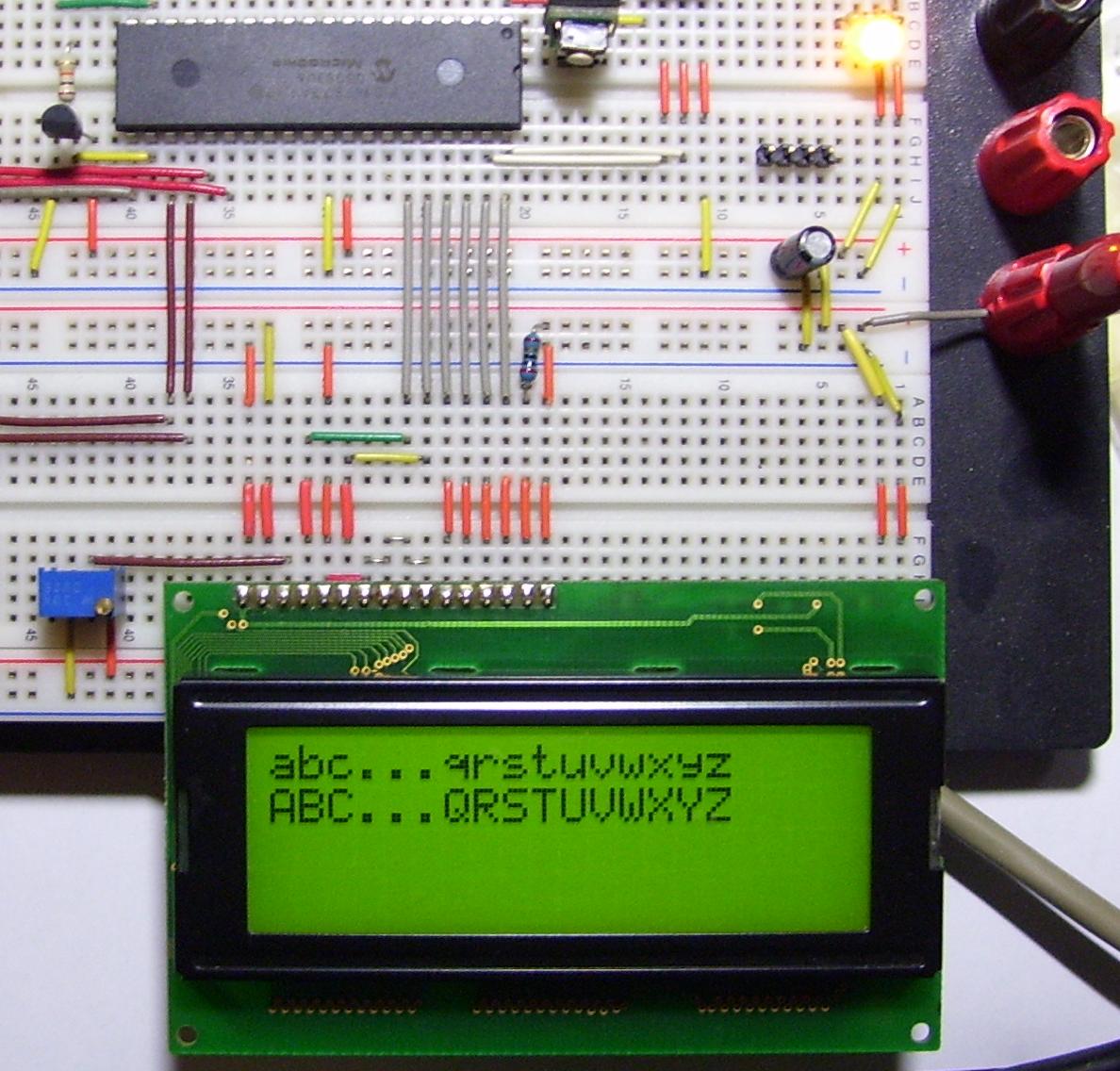

    Your photo has given me a good clue; I see that you are using B.2 and B.3. Up til now I'd been using B.0 and B.1 only.
    It turns out that it only works from B.1 onwards (with both PBP *and* LCD_AnyPin). I thought it might be because of a hardware fault, but B.0 is fine with a temporary LED.
    It's all rather strange because the PBP manual implies that any PortB pin should work.
    Do you mind if I trouble you for one more question, pse?
    Could you have a look at my CONFIG and perhaps let me know why MSC gives an error when I try to compile without the semicolon?
    Thanks again to you for doing all that work on my account.
  25. #65
    Well, I moved E and RS to RB0 and RB1 ... it still works.
    You might try turning that LED around and see if PORTB.0 will drive the output both ways.
    It could be that half of the output stage is toasted.
    And for the config error, you just need to comment the default configs in the .inc file.
    See this page ... http://melabs.com/support/config_defaults.htm
  26. #66
    May 2010
    9
    Thanks again, Darrel.
    You will no doubt be chuffed to hear that your prognosis was 100% correct.
    I tried your LED suggestion and can confirm that PortB.0 was indeed dead - both ways. I've just taken delivery of some new '877s. Your LCD_AnyPin and all Ports are now working perfectly.
    I think I owe you an apology for sending you all around the houses in the first place; I really should have had the noodle to check that port with a LED before bothering you. For what it's worth, I'm sorry for wasting your time, but I do appreciate you coming back just the same.
    From myself, and on behalf of all the other members here, top thanks to you for sharing your work, and top thanks for sharing your much-appreciated know-how.
    Thanks also for the heads-up regarding the Config thing.
