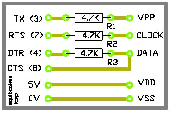

    I've tried to make this programmer but somehow I can't program the 12C508a, here is what happends:
    I can read the PIC with no problems in ICprog but when I press the program button it gives me an error on 0000h I've checked the Voltage and I have 5V between GND and VCC as expected (I'm powering the programmer through USB since it gives 5V) and between GND and VPP I have -10V without the PIC placed in the socket ofc...its a bit strange to have a value so low isn't it? Can anyone please help me I'm getting crazy with this already screwed 3 PICS...can read them but cant write Thnx
  11. #91
    10V is way too low, this have to be ~13V. This kind of programmer is really not recommended anyways.. worst if you use a USB to Serial converter.
    There's few variant of such cheap programmer like JDM, JDM2, Taits, Ludipo, ElCheapo, PicBlaster and the list is long... none of those seems to work properly... even worst with Vista
    I've been told the parrallel PIC programmer in the list above work better... BUT ANYWAY...invest ~40$ and buy yourself a real Microchip PICKit 2 or a clone like JuneBug.
    and huh.. why not using 12F508 wich is a flash version.. so you can write on it again and again... and again.

    Can you update the schematic to be used with 18F452 ?
    Ramon.
  14. #94
    Apr 2008
    24
    Here I have a LVP-cable, very similar to yours ...
    >>> http://home.vrweb.de/~lotharstolz/st...vpc/index.html
    It does NOT work for me, and my RS-232 provides 10 volts.
    Is this a problem ?
    I thought LVP got "L" from "LOW" voltage, only 5 volts all around.
    Am I wrong ?
    The resistors here are 10 K, whilst yours are 4K7. Is this important ?
    I see 2 mA shall flow in your circuit, and only 1 mA in the LOTHAR desing ...

    Forgive me for dragging an old topic, but i found this thread via Google and am new to the forum ( HI )..
    I am trying to get this to work on a PIC16F88, it was posted that it worked fine but i have been trying for hours.
    I have no experience of PICs at all, and all i am simply trying to do is build a design i got online that comes with the .hex firmware already. I simply need to get this firmware onto the PIC and away i can go.
    Have read the datasheet for the pic, and about ICSP in circuit, and read this topic 3-4 times now. Heres how i have it so far, but i think its wrong?
    9pin serial 16F88 pin
    3 4.7k 4 (vpp/mclr)
    5 -- 5 (Grd)
    4 4.7k 13 (Data ? PGD)
    8 -- 12 (Data ? PGC)
    7 4.7k ?? (which port?)
    Then i use my circuits 5v to supply 5v to vdd, i measured my PC serial port on pin 3 as 10v, is that enough or is that my problem? I see in datasheet about low-voltage programming is an option but wasn't sure how to connect that up?
    I have then tried both Ic-Prog and Winpic to "upload" the .hex firmware to my pic (still in circuit but connected as above) but neither seems to be working? Cant even tell if its connecting to the pic? In Winpic it says "failed to initialise programmer" and in Ic-Prog it just fails on verify. I have set both softwares to programmer "JDM" type as instructed.
    Where am i going wrong, and what are the correct pins and settings for PIC16F88 please?
  16. #96
    Default pgd is data and pgc is clock.
    pins are wrong. pgd is data and pgc is clock. so is like this: 3-4.7k-4, 5--5, 4-4.7k-13, 8---13, 7-4.7k-12. sorry for formatting, am on my phone. also, if code protect is on, it will fail verify as it will not be able to read the code back from the pic (protected).

    Quote Originally Posted by Squibcakes View Post
    Hi guys,
    I have been using this simple programmer.. why pay big bucks for a PIC programmer when this one costs just cents! In fact I have stopped using my 'other programmer' all together now.
    All you need is:
    three 4.7k Resistors,
    a few wires (1m)
    9 pin d-connector (female),
    and a 5 volt dc supply.
    I have used it on 16F84, 16F62X, 16F87X chips without problems.
    To make it:
    TXD (3) ------[4.7k]-------VPP
    GND (5) --------------------VSS
    DTR (4) -------[4.7k]------DATA
    CTS (8) ------------------DATA
    RTS (7) -------[4.7k]------CLK
    Numbers in Bracket are the connections on the 9-Pin D-Connector.
    I have made up a small PCB to mount the resistors on but... you could just solder them in line to go cheap.. Just be carefull they dont short out. If anyone wants the PCB footprint I can post it.
    Then just put your PIC into a breadboard, connect your 5 volt supply to VDD/VSS, and away you go.

    TXD (3) ------[4.7k]-------VPP (PIN 1)
    GND (5) --------------------VSS (PIN 8 or 19)
    DTR (4) -------[4.7k]------DATA (PIN 28)
    CTS (8) ------------------DATA (PIN 28)
    RTS (7) -------[4.7k]------CLK (PIN 27)
    + (5V power supply) -------VDD (PIN 20)
    - (5V power supply) -------VSS (PIN 8 or 19)

    Hi Mark,
    This circuit requires an external 5v regardless. In saying that, I haven't had much luck using laptops when programming pics with this circuit. (after all this is a very simple cheap programmer!)
    Laptops don't put out high enough voltages on the serial lines.
    Attached is copy of circuit board you can use to make this programmer. Have fun!
    Cheers
