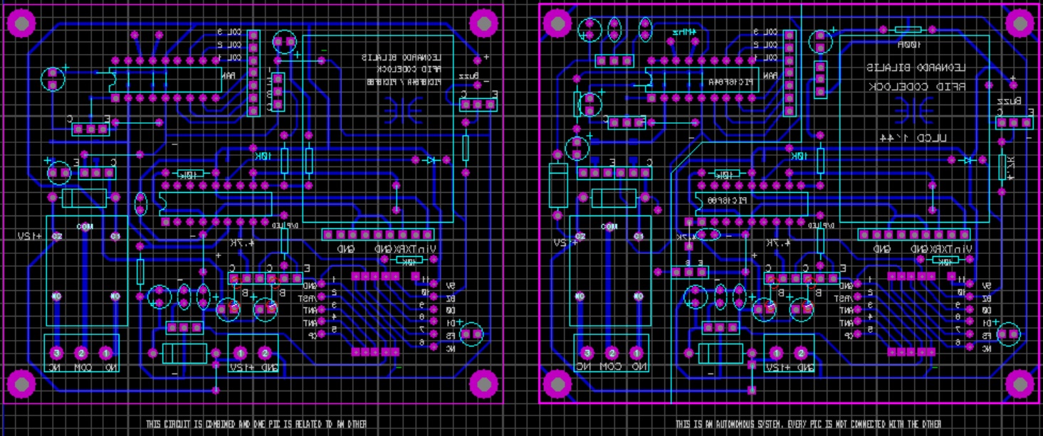

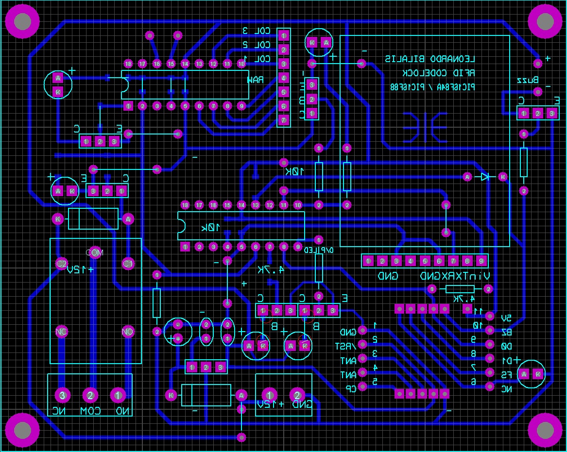

    apologize for my absent so many years.
    I was working in Dubai for 4 years and really didnt have a time to login. I have more than a flight per day, so you understand that i wasnt able at all to handle many things at a time.
    Now im back to real life, and i will upload the code and the circuits as well tonight.
    Imagine that for so long time, the circuit remains the same in my lab, and i havent done anything to it yet apart from adding a second circuit, beside it with a keypad.
    None of the core of the codes are mine, i just did some configurations and changes to fit my needs. (im not proud of this, as i would like ones to write completely my own code from the scratch)
    The following image shows the circuit and the connection of one circuit to an other.
    I know that it is difficult to understand the schematic, as it is not corresponds at the moment to a circuit, but i have it on a TEST Board and i can do a small video of it.
    As i have mentioned, there are two circuits, separated, the RFID circuit (with the uLCD) and the CODELOCK with keyboard.
    What the circuit does:
    1) once you place the Tag to the RFID reader, the uLCD, displays the picture of the person carries the RFID tag
    2) at the same time, a BEEP on the buzzer is activated and sends a command to activate the second circuit.
    3) You have 5 seconds until you add the code on the keypad otherwise the circuit lose its power and is not activated any more.

  21. #101
    Oct 2010
    413
    Default Re: How to compare strings/array? RFID Project
    Finally i did a second circuit, which both of the PICs are not related to once each other, but they are a separate operational circuits. Each of then drives the same relay.
    As i have told you this a circuits that will be outside on a main door in a small Village, so people that would like to come in, they need to know either the PASSCODE on the Keypad, or to have with them an RFID key.
    After a small discussion we had, old people didnt like to carry an RFID key, so they requested if it is possible to have only the keypad.
    On the other side, the younger of the family, liked the idea of the rfid, which the only downside it is to take care not to loose it. Ofcourse both will know the main password on the keypad so, for those will have an rfid key, if once does not work, will have the option to use the keypad to access the door.
    To be honest, in nowadays, especially in the village, you do not need a super extreme security system. In addition to that, the simplest the better!!!
    I understand that to carry an RFID key is the same as to have the real key to open the door. In my next experiment i will try to include a fingerprint sensor, but im waiting to see a good one, because at the moment none is so reliable.
    Name:  rfid circuit.jpg
